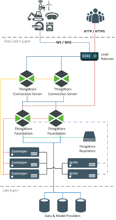

What is a load balancer’s role in the ThingWorx Active-Active Clustering setup?
As is true of any load balancer, the load balancer required in the ThingWorx Foundation active-active clustering architecture is responsible for distributing incoming traffic across the nodes within the cluster.
In the Active-Active Clustering architecture for ThingWorx, the load balancer distributes the traffic using a round-robin method. Please note that there are a several algorithms that provide load balancing techniques and this article is a good read for further understanding of it. A round-robin method rotates servers by directing traffic to the first available server and then moves that server to the bottom of the queue.
In ThingWorx clustering setup, while both WebSocket and HTTP incoming traffic are handled in a round-robin manner, they are routed differently by the load balancer.
HTTP traffic is directly distributed amongst the ThingWorx Foundation Servers within the cluster. Sticky sessions are used for the HTTP sessions—sticky via cookie, so individual users are tied directly to a single server node and see all of their changes instantaneously.
WebSocket traffic is distributed across the and is balanced via source IP to ensure each request from a device goes through the same connection server. From the ThingWorx Connection Server, the device traffic is distributed amongst the underlying ThingWorx Foundation Servers, not requiring another load balancer between the ThingWorx Connection Servers and ThingWorx Foundation Servers.
Please note that the WebSocket traffic load does not necessarily get distributed evenly nor do the incoming requests due to stickiness. For example:
  • 2 users connect HTTP, one sends 100 requests and the other sends 2. Since they are sticky, it is not distributed evenly.
  • 2 devices connect to a ThingWorx Connection Server. 1 is a gateway for 100 other devices, all requests fthe gateway go to the same connection server. The Connection Server does a round-robin to the underlying Foundation Servers so that the load would be better distributed across, but the load balancer is sticky to a ThingWorx Connection Server.
