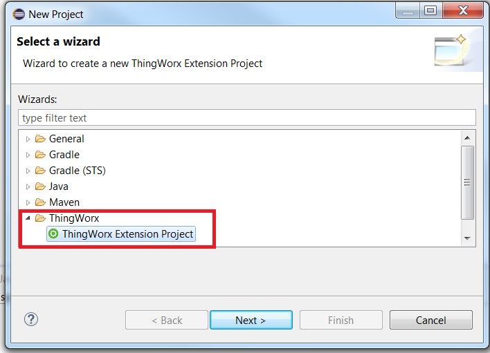

  1. Go to File->New->Project.
  2. Click ThingWorx->ThingWorx Extension Project.
  3.  Click Next.

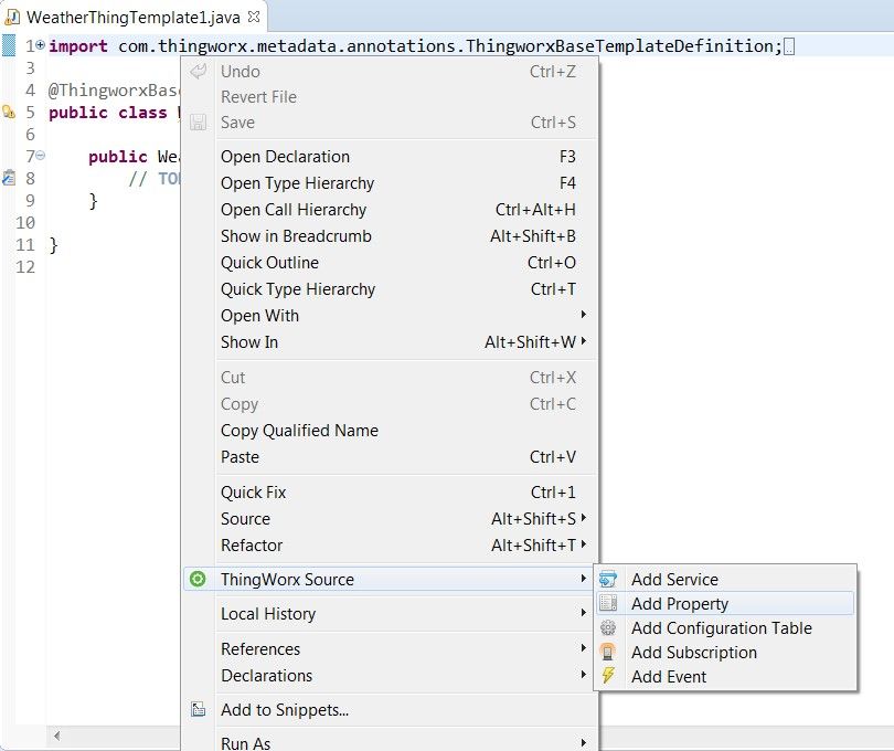

In this section, you are going to add CurrentCity, Temperature and WeatherDescription properties to the WeatherThingTemplate. These properties are associated with the Thing Template and add the @ThingworxPropertyDefinitions annotation before the class definition in the code.
  1. Right click inside the WeatherThingTemplate class or right click on the WeatherThingTemplate class from the Package Explorer.
  2. Select ThingWorx Source-> Add Property.

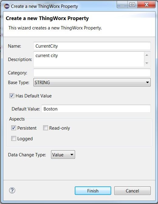

  3. In the popup window, create a property to store the city name.
    • Name = CurrentCity, Base Type = STRING, Description = ‘’
    • Select the Has Default Value checkbox and enter a city name (eg. Boston). This will be the default value unless a specific value is passed.
    • Select the “Persistent” checkbox. This will maintain the property value if a system restart occurs. NOTE: If you select the Logged checkbox, the property value is logged to a data store. If you select the Read Only checkbox, the data will be static.
    • Select VALUE from the Data Change Type drop down menu
          NOTE: This allows any Thing in the system to subscribe to a data change event for this property.
  4. Choose to use one of the following Data Change Types:
    Data ChangeType Description
    AlwaysFires the event to subscribers for any property value change
    NeverDoes not fire a change event
    OnFor most values, any change will trigger this.
    OffFires the event if the new value is false
    ValueFor numbers, if the new value has changed by more than the threshold value, fire the change event. For non-numbers, this setting behaves the same as Always.
  5. Select Finish.

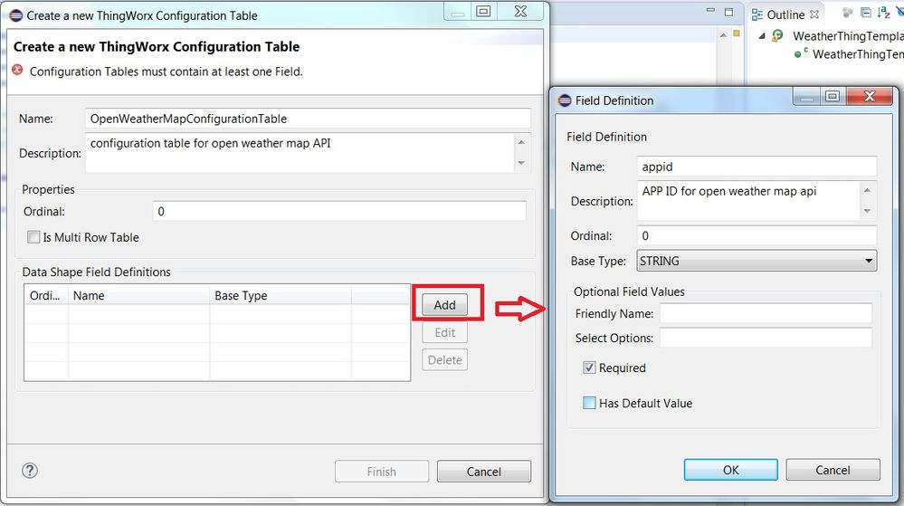

In this part of the lesson, we will create a configuration table to store the API Id that you generated from the openMapsWeather. Configuration tables are used for Thing Templates to store values similar to properties that do not change often.
  1. Right-click inside the WeatherThingTemplate class and select ThingWorx Source->Add Configuration Table.
  2. Create a new configuration table with name OpenWeatherMapConfigurationTable.
  3. Click Add in the Data Shape Field Definitions frame.
    NOTE: Configuration tables require fields (columns) with a defined table structure (DataShape).
  4. Enter appid as the name with a base type STRING.
  5. Select the Required checkbox.
  6. Click OK, then Finish to add the Configuration Table
