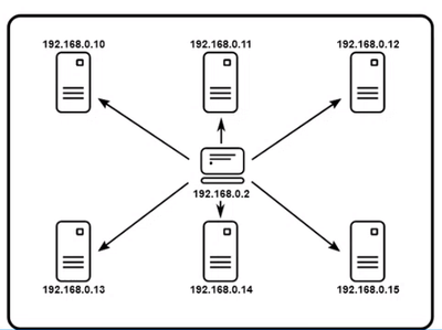

imageRemote Testing configuration in which the main JMeter client is located at one IP address, controlling the rest as they step through their own copies of the JMeter tests, based on their own unique data files as necessary, to simulate a user load across a network, a series of regions, or simply across many machines if limited by the size of the physical hardware [JMeter link for this image in text body below]
One key aspect of a proper JMeter load test is distributed or remote testing, i.e. making use of more than one JMeter client at a time to simulate the user load on the Application server. There are many reasons to make use of a network of clients such as this, like mimicking cross-region user access to the Foundation server, simulating different levels of latency for different users, and increasing the overall number of users which can contribute to the load test, while minimizing the performance cost of hosting that many threads on any single server.

     With a simple (monolithic) distributed test, all of the JMeter clients are located on the same host and share an IP address, but each must be configured with a unique RMI port to connect to the controlling process. If these are located on a VM, then the resource specifications can merely be increased and the VM sized larger as necessary to ensure the network of JMeter clients runs as expected. Each JMeter client requires around 8 GB for its heap size and 1 CPU (with some additional resources for the host operating system).
Multi-hosted testing becomes the required option when limited by physical hardware (or a relatively small VM hardware host). If there are only 4-core, 32-GB machines, then plan for a machine per every 3 JMeter clients. If simulating thousands of users, this could mean half a dozen machines or more are required, which can still sometimes work out to be more cost efficient than one large, 256 GB, VM hosted in the cloud. Using many hosts in physical locations can also simulate regions with different network characteristics.

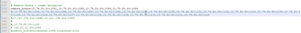

  2. In the “jmeter.properties” file for the main server, specify the IPs and ports for each remote/distributed client (under remote_hosts), as shown:
    imageIn this image, the IPs are all the same, with just the port differing from client to client. Here only 4 clients are in use, with the rest commented out for future tests. This is how to scale up and test incrementally more users each time. Just add another server to add another 150-250 users, until eventually the target number of users is reached, or the server is saturated. These IPs will differ if doing a true remote test, with each being the server location of the JMeter client within the same network. The combination of IP address and port will all still need to be unique, and communication between the overall jmeter controller and the clients over the RMI ports needs to be allowed by the network/firewalls.
