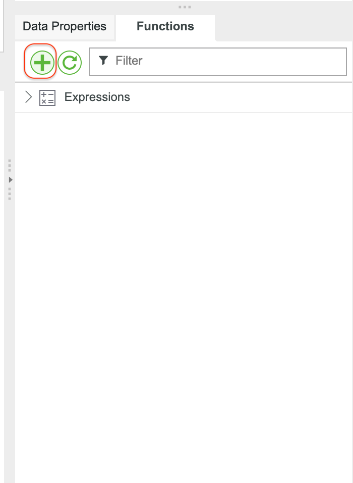

  1. Open the MyFunctionsMashup Mashup to the Design tab.
  2. Click the green + button in the Functions area.
  3. In the New Function modal, select Validator.
  4. Set the Name to isDataClean.
