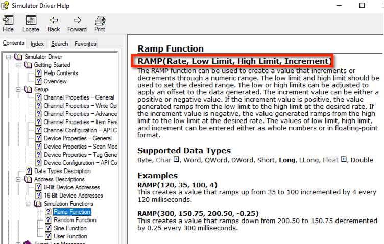

  1. Understand how to configure Kepware as a simulator
    1. Go to the Help menu within Kepware, and click on “Driver Help”
    2. Select “Simulator” in the pop-up window, and click “OK”
    3. Expand “Address Descriptions” and then “Simulation Functions”
    4. Select “Ramp Function” to review details about the function needed for this tutorial, as well as information about function syntax
    5. Close the window once this information has been reviewed

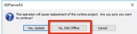

    1. Click “File” > “New”
    2. In case you are connected to runtime, Kepware will allow you to choose to edit this project offline

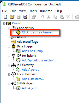

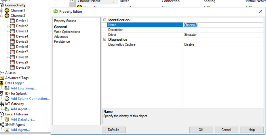

  3. Add a channel in Kepware
    1. Channels represent threads which Kepware will use to contact ThingWorx

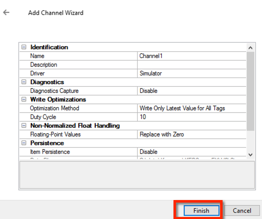

    2. Under “Connectivity”, click “Click to add a channel.”
    3. From the drop-down list, select “Simulator”
    4. Use all the default settings, selecting “Next” all the way down to “Finish”

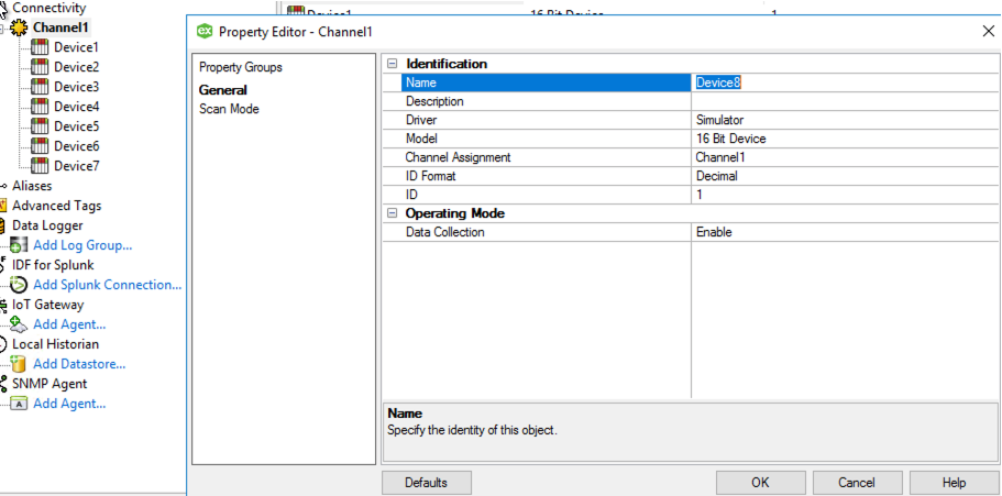

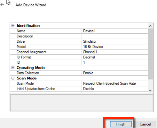

  4. Next, add one device to the channel
    1. Highlight the new channel and click “Click to add a device” (which will appear in the center of the screen)
    2. Once again, use the default settings, selecting “Next” all the way down to “Finish”

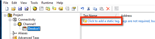

    1. Highlight the device created in the previous step and click “Click to add static tag”, which appears in the center of the screen
    2. For “name” type “tag1”
    3. For Address, enter the Ramp function: RAMP(1000,1,2000000,1)
      1. The first parameter is the update rate given in milliseconds
      2. The next two parameters are the range of values which can be sent
      3. The last parameter is the increment or step
      4. Together this means that every 1 second, this tag will send a new value that is 1 higher than the previous value to the Platform, starting at 1 and ending at 2 million

  6. Add more devices to the test
    The most basic set-up is now done: if this project connected to the Platform, one remote thing with one remote property could be used to simulate property updates. That is not very useful for load testing, however. We need many more things than this, and many more properties. The number of tags on each device should match the expected number of remote properties in the application itself. The number of devices in each channel should be large enough that when more channels are created, the number of total devices is close to the target for the application. For example, to simulate 10,000 things, each with 25 remote properties, we need 25 tags per device, 200 devices per channel, and 50 channels. This would require a lot of memory to run and should not be attempted on a local machine.

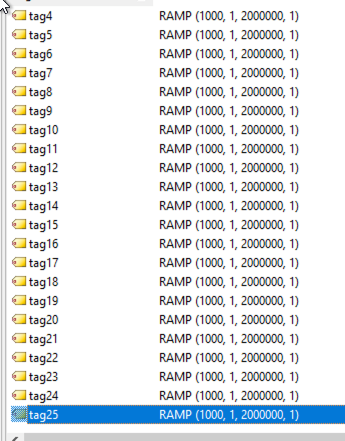

    1.  To add more tags, copy and paste the existing tag (ctrl+c  and ctrl+v  work in Kepware for convenience) until there as many tags as desired

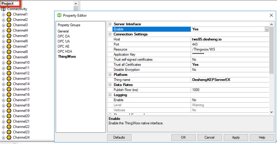

  7.  Configure the ThingWorx connection
    1. Right click on Project in the left-hand navigation bar and in the pop-up window that appears, highlight ThingWorx
    2. Change the “Enable” field to “Yes” to activate the other fields
    3. Fill in the details for “Host”, “Port”, “Application Key”, and “Thing name”
    4. Note that the application key will need to be created in ThingWorx and then the value copied in here
    5. The certificate and encryption settings may also need to be adjusted to match your environment
    6. For local set-ups, it is likely that self-signed and all certificates will need to be accepted, so both of those fields will likely need to be set to “Yes” (Encryption may need to be disabled as well). In production systems, this should not be the case

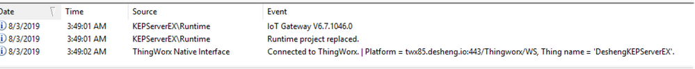

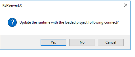

  9. Connect to ThingWorx
    1. Click “Runtime” > “Connect…”
    2. A pop-up will appear asking if you want to load this project, click “Yes”
    3. The connection status should then appear in the bottom portion of the window where the logs are displayed

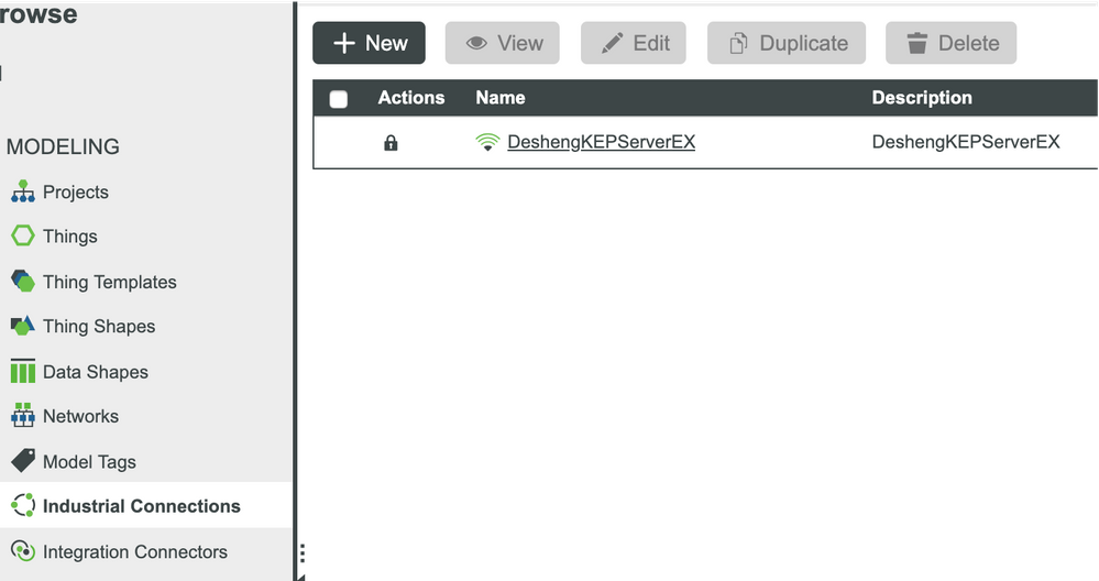

  10. Configure in ThingWorx
    1. Login to the ThingWorx Platform
    2. Under “Industrial Connections” a thing should appear which is named as indicated in the Kepware configuration step above
    3. Click to open this thing and save it

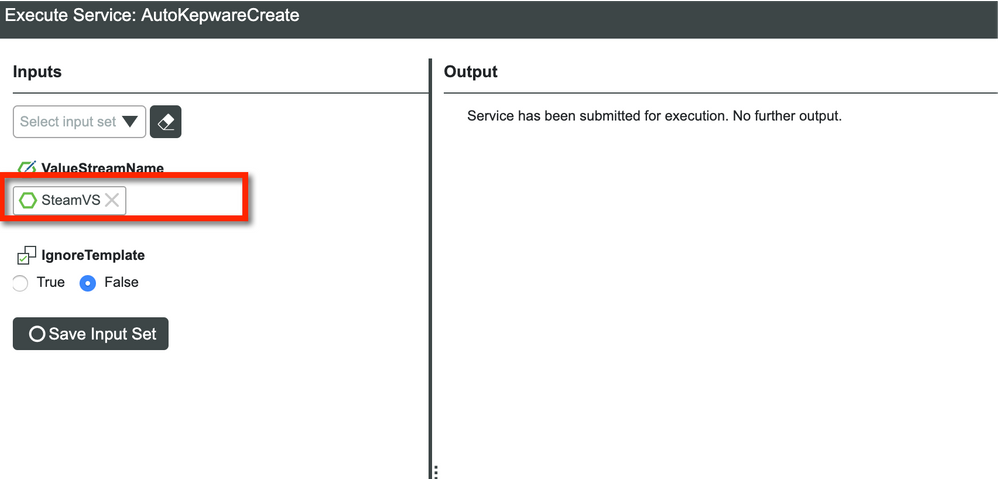

  11. Create remote things in ThingWorx

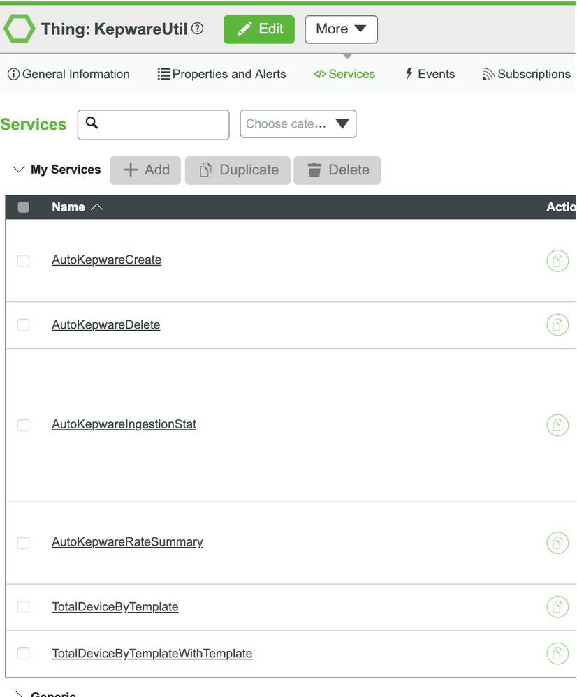

    1. Import the provided entity into ThingWorx (should appear as a downloadable attachment to this post)
    2. Open the KepwareUtil thing and go to the services tab
    3. Run the AutoKepwareCreate service to generate remote things on the Platform
    4. Give the name of the stream created above so each thing has a place to store property information
    5. The IgnoreTemplate flag should be set to false. This allows for the service to create a thing template first, which is then passed to the remote devices. The only reason this would be set to true is if the devices need to be deleted and recreated, but the template does not (then set the flag to true). To delete the devices, use the AutoKepwareDelete service also provided on the KepwareUtil thing
    6. Note that the AutoKepwareCreate service is asynchronous, so once it is executed, close the window and check the script logs to see when it completes. The logs will look like: KepwareUtil AutoKepwareCreate task finished!!!

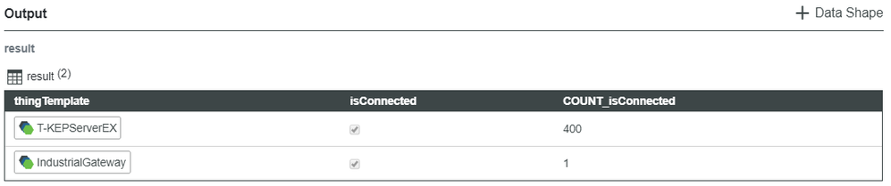

  12. Check status of remote things
    1. Once the things are created, they should automatically connect to the Platform
    2. Run the TotalDeviceByTemplateWithTemplate service to see if the things are connected
    3. The template given here could be the one created by the AutoKepwareCreate service, or just give it RemoteThings if this is a small local set-up without many remote things on it
    4. The number of devices will equal the number of devices per channel times the total number of channels, which in the test shown here, is 400
    5. isConnected will be checked if all of the devices are connected without issue
    6. If some of them are not connected, verify in the logs if there are any errors and resolve those before moving on

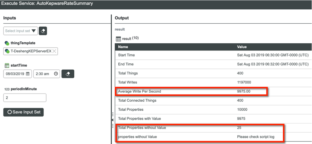

  13. View Ingestion Rate
    1. Once the devices are created, their tags should show as numbers (NOT integers), and they should already be updating with new values every second
    2. To view the ingestion rate, run the KepwareUtil service AutoKepwareRateSummary
    3. Give the thing template name that is created by the AutoKepwareCreate service, which will look like the name of the Kepware thing itself with a “T-“ in the front
    4. The start time should be close to the current time, and the periodInMinutes should be large enough to include some of the test (periodInMinutes is used to calculate the end time within the service)
    5. Note in the results here that the Average Write Per Second is only 9975 wps, which is close but not exactly what we would expect. This means that there are properties not updating correctly, which requires us to look at the logs and restart some things. If nothing shows up here, despite the Total Connected Things showing correctly, then look at the type of the tags on one of the remote devices. The type must be NUMBER for the query within this service to work, and not INTEGER. If the type of the tags is incorrect, then the type of the tags within Kepware was probably given as something which is not interpreted as a number in ThingWorx. Ensure DWord is used for the tags in Kepware

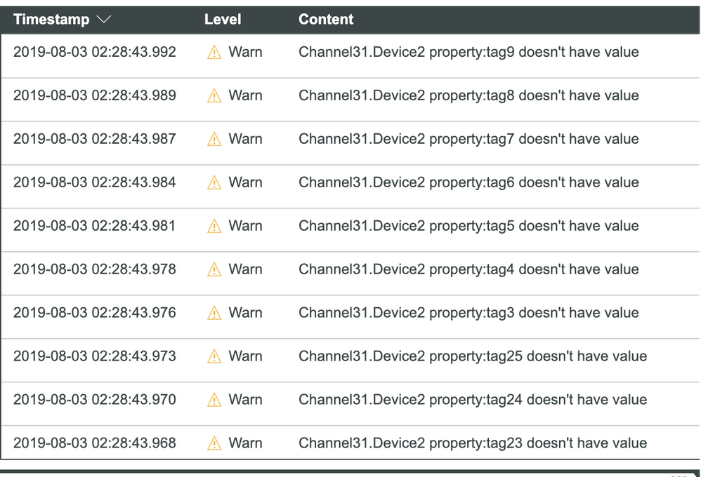

    6. Within the script log, look for any devices which show errors as seen in the image below and restart them to get their properties updating correctly

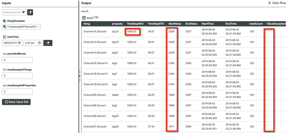

  14. Once the ingestion rate equals what is expected (in the case of the test here, 10,000 wps), use the AutoKepwareIngestionStat service on the KepwareUtil thing to see details about each remote device
    1. The TimeGapAvg in this service represents the gap between two ingestions in milliseconds, showing any lag that may be present between Kepware and ThingWorx
    2. The TimeGapSTD shows the standard deviation of the time gap between two ingestions on any given thing, also indicating lag (the lower this number, the better)
    3. The StartTime and EndTime show the first and last timestamp observed in the ThingWorx database during the given duration
    4. The totalCount shows the total number of ingested records during the sampling cycle
    5. The StartValue and EndValue fields show the first and last value ingested into the tag during the given duration
    6. If the ingestion rate is working as expected, and the ramp function is actually sending an update on time (in this case, once each second), then the difference between the EndValue and StartValue should always be equal to the totalCount plus 1. If this doesn’t match up, then there may be data loss or something else wrong with the property updates, which will show as a checked box in the valueException column. It is not enough to ensure that the ingestion rate is correct, as sometimes the rate may fluctuate only by 1 or 2 wps and appear perfect, even while some data is lost. That is why it is important to ensure that there are no valueException boxes showing as checked in the test of the application. If none of these are marked as having failed, then the test was successful and this ingestion rate is acceptable for the application
