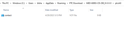

Hi.
I was able to install software.  I located installation files which PTC Web installation assistant -software download to computer and then installed manually.
  • First run pim_installmgr_mathcad.exe and when it gives "error at 1%" after downloading files
  • Go  (Windows 10) C:\Users\YourUsername\AppData\Roaming\PTC Download\MED-XXX-XX-XXX_X-X-X-X\ptcsh0\
  • run PrimeWixInstaller_64bit.msi installation file.
Hopefully this help.

I have been trying to repair a function with a new istallation, but I keep getting stuck at 0% on downloaded files in the installation  step.  This has persisted for over 24 hours.  I need this program functioning, any help or updates would be much appreciated.
Britt
Yes, been through as much of that as I could including the multistep process to look for the PrimeWixInstaller_64bit.msi installation file
All I have there is the contact file.; no PrimeWixInstaller_64bit.msi installation file
I have spent hours and tried everything I can find to try..
I have spent lots of time on this, because I desperately need this software working to finish up a class.  I had MathCad running, but wound up uninstalling to reinstall it because the worksheet converter was not working and I cannot get the reinstall to work.  This is extremely frustrating and I have spent several hours fighting this because I do not have a choice.  I really need someone to help.
