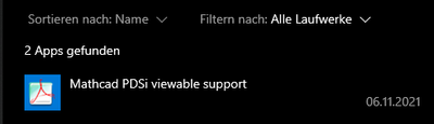

And you installed it earlier - "Mathcad PDSi Viewable support"?
mackintoosh
(To:VladimirN)
Yes i got it installed
