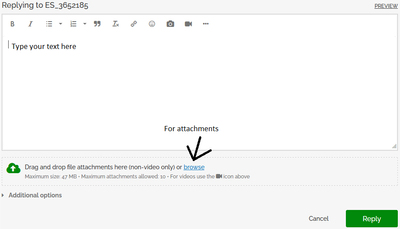

Assuming you're using the online forum, the form to place any content looks like this:

OK, I think this will work.  Never used a forum before!
