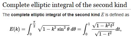

It seems strange to me, but I am not finding in the forum any previous post to the subject.  I need to calculate the Complete Elliptic Integral of the 2nd kind.
Since it will be evaluated many times inside a double loop, it would be probably unwise to define it using its "integral definition", because of performance.
(from Wikipedia... sorry, I am not a mathematician...)
