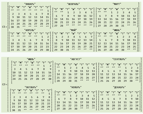

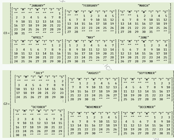

To cut a short story long, in response to the OPs, @VladimirN posted Original Mathcad worksheets containing some date and time functions.  However, as an Express-only user, I couldn't do much with them.   Then, over the weekend, I remembered that I'd converted my old worksheet collection into Prime the last time I had a trial licence, and found a similar-looking file.   So, I had a brief look at Expressifying it.
I then looked for a suitable home for the resulting worksheet and found this thread, which looks like the source of the original material.   So, @RichardJ @terryhendicott , еще раз спасибо for the originals.
And еще раз, I lament the inability to hide quote marks in Mathcad strings ... or to have a handy selection of symbols that numerically evaluate to themselves (apart from decimal digits and NaN (*) - ISTR that π in the units placeholder would stay as π in M15?
As proof of the (soon-to-be-Christmas) pudding, here's a 2022 Mathcad calendar.
And by way of Благодарность to Vladimir,
