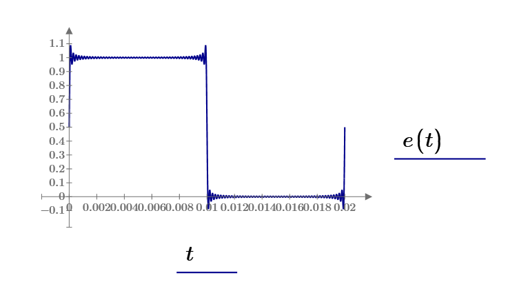

Hi guys, so I am having this problem with ploting graphics, I only need to do this simple Fourier Series and plot it, but it doesn't work. I will show the problems with some images and the program itself.
1 ACCEPTED SOLUTION

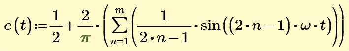

Before you try to plot a function, you should test the function for a couple of arguments
You function fails because of a division by zero for any argument you provide!
Reason is this:
The sum should start with i=1 and you have to deal separately with the signal's DC component if necessary.
You may also consider making n a second argument of the function f so you can compare the result of different number of summands

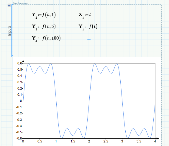

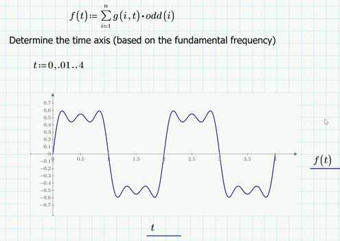

Thanks for the observation, I understood the help note on the software. Think is the professors article was with this exactly expression. So I had no ideia how to solve it, added to it I am still studying this kind of Fourier Series and Solving circuits problems. Last but not least, how can I make the f(t,1), f(t,5) and f(t,100)? I am new at this software.Captura de tela 2023-07-18 221403.png

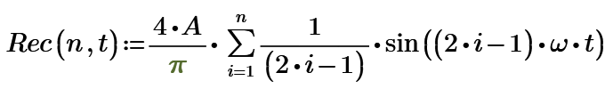

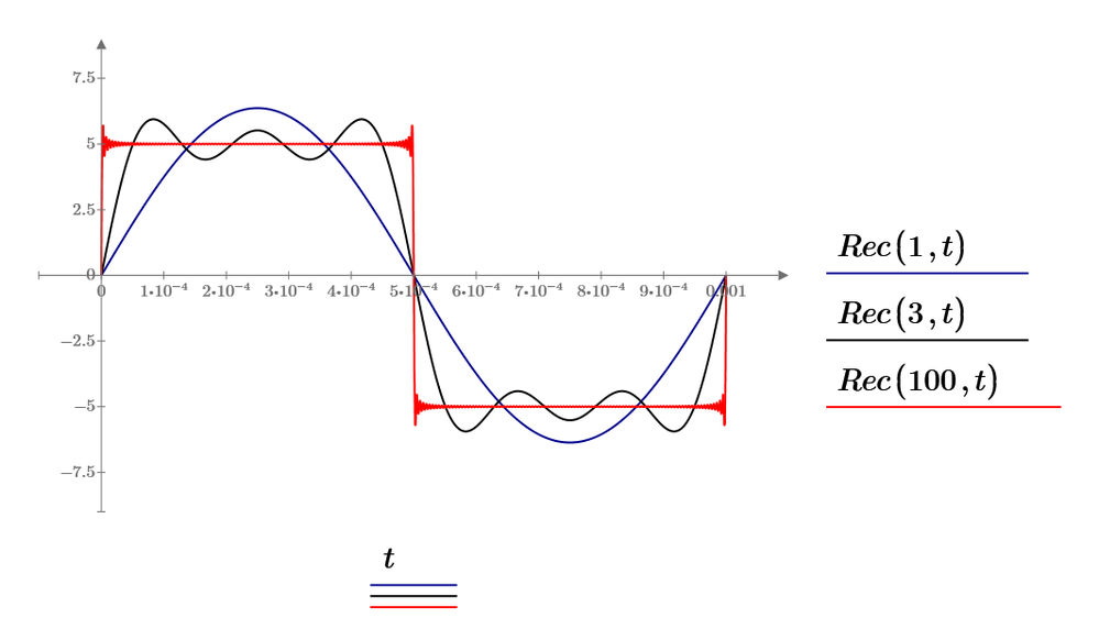

image.pngimage.pngi starts from 1 as Werner note it.
ttokoro
20-Turquoise
(To:ttokoro)
f:=1000  means 1kHz. So the T of the function is 1ms. If use f:=1000 then x axis is from 0,0.00001..0.002.
function f and frequency f are confusing.  So I use Rec(n,t). If you change f:=4 and T:=0.25 you can get the plot.

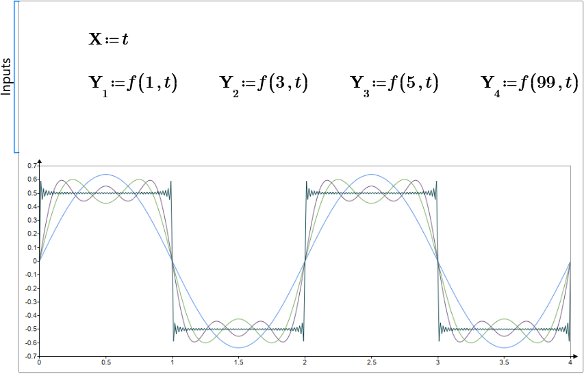

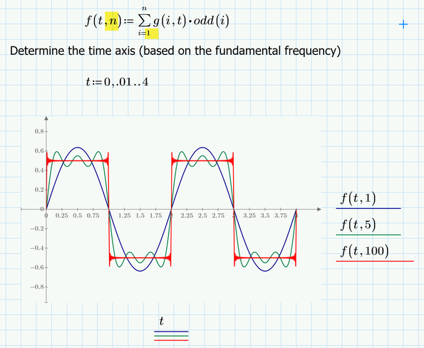

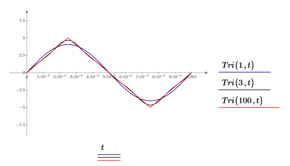

In the pdf in your other answer I see that you already found a solution for plotting more than one trace with the chart component by defining X1 , X3, etc.
If all traces should use the same abscissa values you can make it even simpler by defining X:=t without any subscript. This will then be used for all plot traces as ttokoro just had shown in his picture.
So in you sheet simply delete the index 1 in the definition of X and you should see all four traces.

Hi guys, so this is Joao de Sousa Luz. Once again I thank you guys very much for the help. I want to say again that I still a College Student, and this software is helping me out with some homework. I'm making the graphics and Fourier Series study on how it helps analysis electrical circuits. Still didn't try last ttkoro answers, but I promise to look on it over this week. Right down I use the plot function on Mathcad to use Werne_E first anser and Ttkoro adding simply worked, for the f(t) ploting didn't work. But, when I wright f(n,t) right above it works.

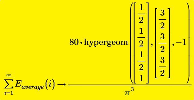

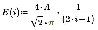

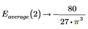

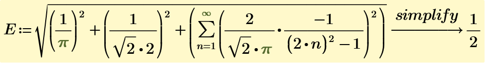

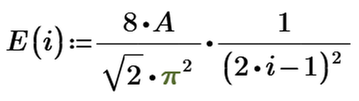

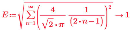

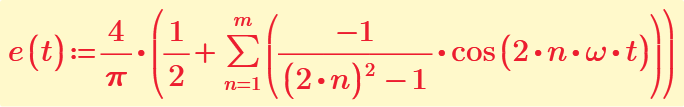

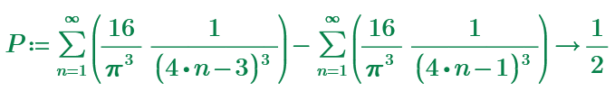

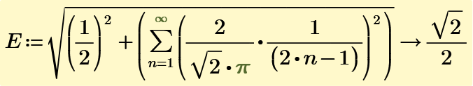

Infinity series of Ea must calculate + series and - series individually.
See attached Prime 9 file.

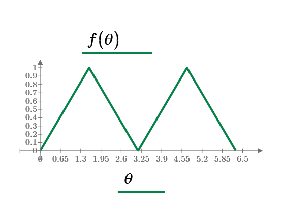

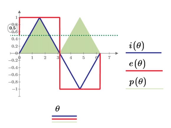

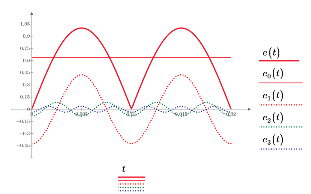

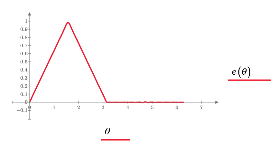

This is the simple Fourier Series probrem of Electrical Engneering.
Electic power by Rectagular voltage and Triangle current.
ttokoro
20-Turquoise
(To:ttokoro)

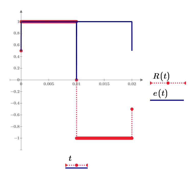

Half-wave rectification waveform.

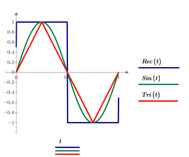

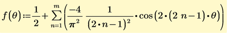

 Full rectified waveforms.
ttokoro
20-Turquoise
(To:ttokoro)

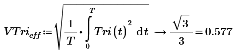

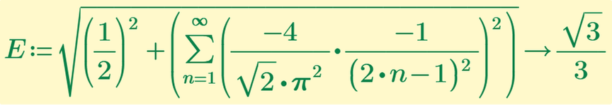

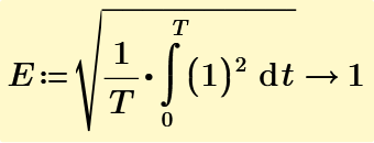

These three functions have same maximum magnitudes 1. The RMS values are 1/sqrt(1), 1/sqrt(2), and 1/sqrt(3), respectivery.
Find functions which have RMS values 1/sqrt(4) and 1/sqrt(5), respectivery. The fmax are also 1 as same as shown at three plots.

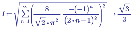

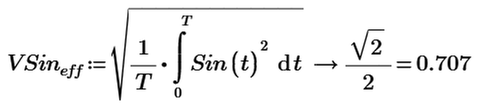

sin(t) function's RMS value is 1/sqrt(2). Find other functions which have same RMS value of 1/sqrt(2). The maximum is also 1. Show the RMS value both from RMS and its Fourier series.

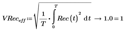

ttokoro

Look at the scaling in ttokoros picture!
The t-values should run from 0 to 1/f = 0.001 to get one period. A low value as he had chosen a higher frequency f.
What the chart component is doing is really bad, though.
I avoid using this chart component for various reasons and rather use the Primes "native" plot feature (as seen in the pics ttokoro and me had posted) even though these plots are missing quite some basic features like grid lines, labels, a secondary y-axis, ...
If you must use the Chart component you may consider defining a range for t with the appropriate values in front of the chart component:
This creates a range which results in the plot traces to consist of 1001 points each.
This should help and you should see a similar plot as the one ttokoro had shown.
To see three periods you simply would change 1/f to 3/f and you may use a larger number than 10^3. Just give it a try.
Defining the range as shown above has the advantage that you can change the frequency back from 1000 to the value 4 which you had used and the plot still will work OK 🙂
