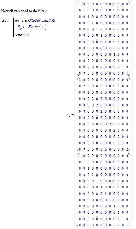

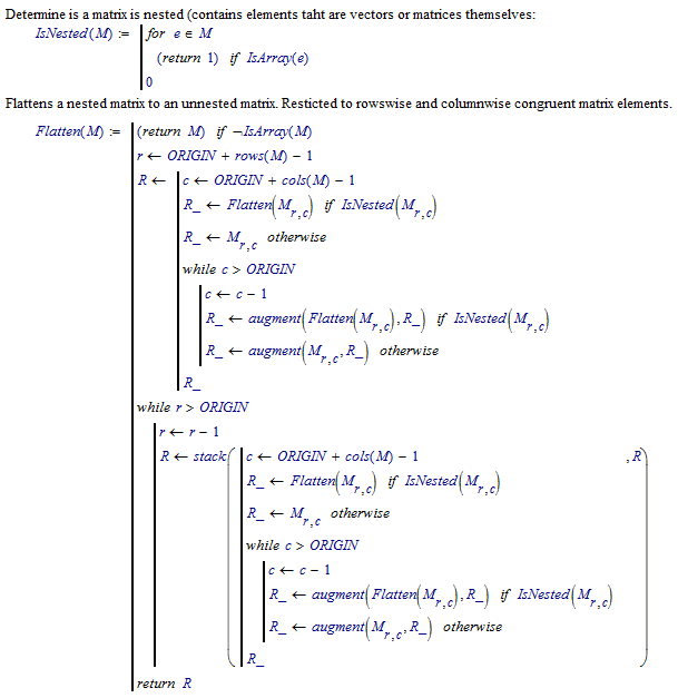

I got some help a while back from here regarding turning a nested array into a single array. Now I have a similar problem in that I need to turn nested matrices into a vector of 3 single matrices. I've tried modifying the code for the arrays but so far unsuccessfully. If anyone can help with this I would be very grateful.

Luc,
That works perfectly, thank you very much! I think I could have sat here trying to come up with that for next year and I wouldn't have even come close.
