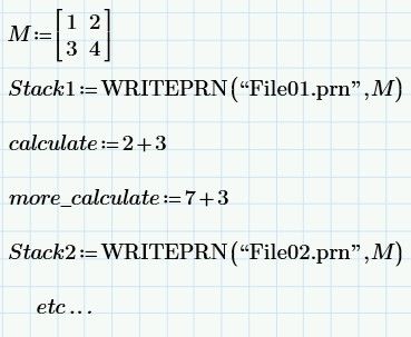

Pepper the file with WRITEPRN statements altering the file name in a sensible fashion.
Prime will write the files until something crashes then you know what is causing the problem.
