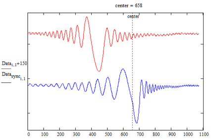

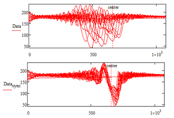

I define as "center" of each data column the position between the highest and lowest value.

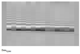

Then I align all those 16 "centers" at a position you can chose (the second argument of the function I provided) and then deal with the upper and the lower part of the data in completely different ways - stretching and compressing the data as needed. Its not a uniform transformation for the whole data column.
Best seen in the plot below which shows the transformation for the second data column (index 1). Notice the bend at the "center" position in the blue curve. The left part is stretched and the right part compressed which means that there is a significant frequency change at the new "center" position which might be undesirable.
Not sure what this means for your application but I guess there sure should be a better method to achieve the desired result.

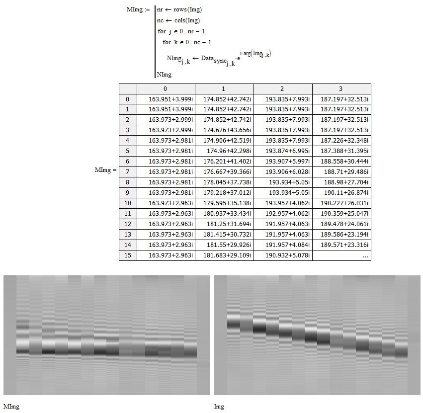

The phase in an image has great importance, so I would use the module instead of the real part. From the original image, I would extract the phase of each pixel which, then , I would multiply exp(i*phase(j,k)) by each Data.sync element in order to obtain the modified image with the same content of the phase of the original image. The result in this case, however, changes very little
