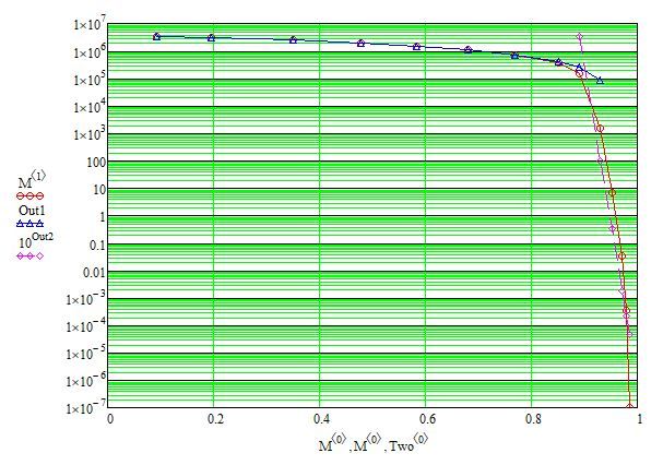

Can you show me one formula for this points? The Mathcad 15 sheet is in attach!
Thank you!

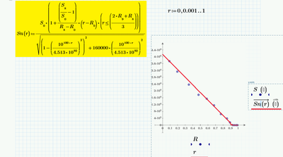

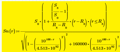

Your plot looked a bit like a low pass filter.
So, with a little sleight of hand. . .
In Prime 4 express
The sheet please!
@Fred_Kohlhepp wrote:
Hi Fred! Send please the sheet! Better Mathcad 15!
Valery,
I don't have version 15 any longer, stuck with Prime 4.0 express!  The last post has your data (thanks SMath) with this solution, the file ochov2.mcdx is a Prime 4.0 file; I'll work on teaching Smath to do this, see if it can write an xmcd file

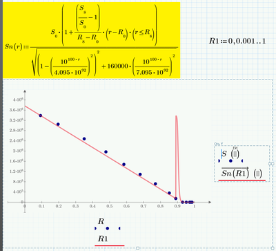

Attached zip has Smath file and Smath saved to xmcd
Sorry
You can adjust the break point to fix that--see below:

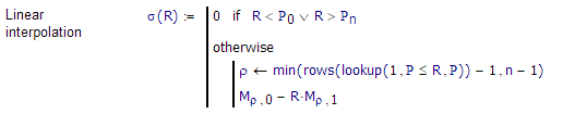

Valery, you showed pics from the linear interpolation in your very first post and you were asked whats wrong with it as its one the easiest ones to be implemented in any programming language. You were asked if you don't like the the "bumps" which it shows in the log plot and are looking for something else for that reason. So I suggested to use linear interpolation of the logarithmized data which is as easy to implement and does not show this undesirable behaviour. You never answered to the questions what you are exactly looking for and why linear interplation would not be acceptable. Fred came up with a very sophisticated solution and even showed you how to adopt it to your needs (you ignored his answer) and now we see that linear interpolation (no one would do it manually in Mathcad) is the solution? I really wonder what the reason for asking here really would have been.
Now I show the formula of this linear interpolation!
I was hoping that with your help I would get a more elegant and short formula. But this did not happen. Thank you all!

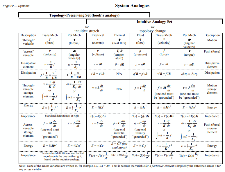

If you recognize the shape of the math of some physical model (for example a thermal model), and know how to interpret it in some other physics field (for example, mechanics), then you can try to found the "thermo-mechanical equivalent" or "analog" interpretation. This applies for electrical, hydraulic, pneumatic and other areas. For example, you can use this table, from http://www.dartmouth.edu/~sullivan/22files/System_analogy_all.pdf
  or check the wikipedia article: https://en.wikipedia.org/wiki/Analogical_models
So, your control theory model probably have a thermal equivalent which is an easy interpretation.

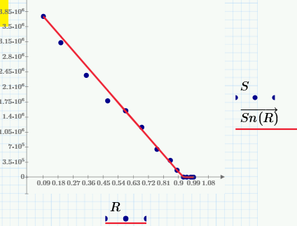

But if the point it's only implement some algorithm in Cpp then I guess that this is the shortest way:

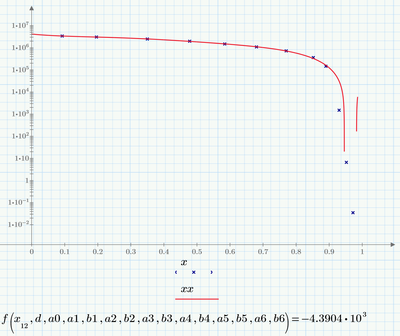

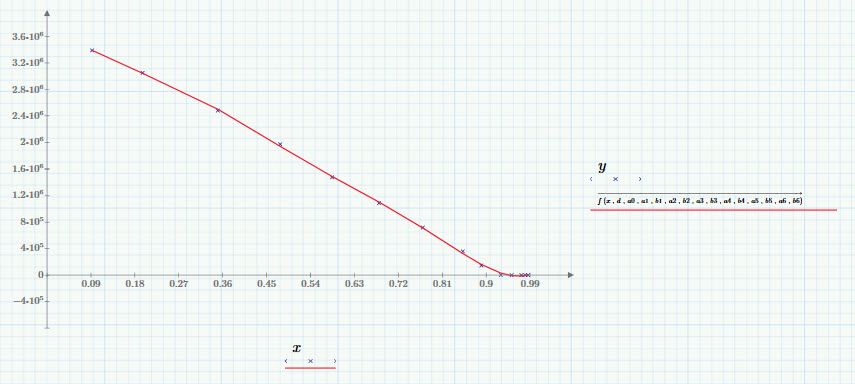

Here's something called Regression Kink Design; seems to be popular in economics.  Does a reasonable job.  It does undershoot the lowest points if you zoom in.  I could only go to 6th order since that's when minerr ran out of variables.
ValeryOchkov
(To:DJF)
Cooooooooooooooooooooooooooooooooooooooooool!
ValeryOchkov
(To:DJF)

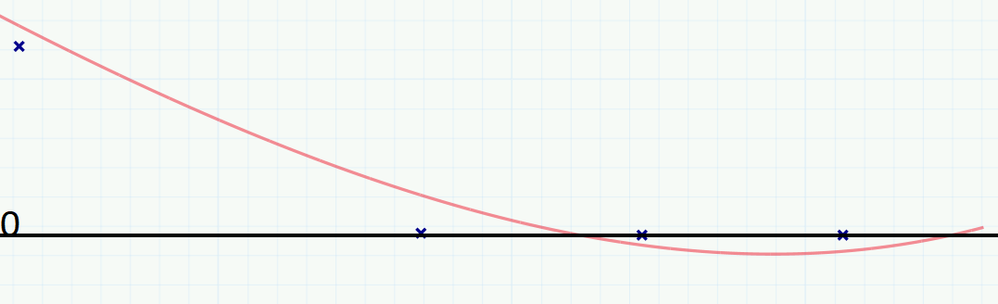

You are getting answers, they are just negative answers (the undershoot I mentioned.)  So they don't show up on a log chart.  As to whether that is acceptable or not depends on what you need for accuracy.  If you can be off by 16000 it works fine.  If not, back to the drawing board.
I had assumed you were after a single equation, if not I'd agree splines would probably work best.
ValeryOchkov
(To:DJF)

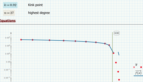

A higher order RKD should help that out some, but I'm not sure how to get there.  Someone will probably tell me 15 can do it.

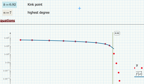

Even Prime can do it, too. But increasing the order doesn't help. After all with n as highest order we have 2*n+2 variables to solve for but still only 14 equations to fulfil.
You may play around with the attached sheet, but I guess this regression will not do whatever Valery has in mind.
Changing the value of the kink point has no big effect, too. Just for fun I added k as an argument of function f and let the solve block optimize k, too, and it came up with k=1.8343.
Worksheet in format P5 attached
DJF
(To:Werner_E)
When k is changed, d just changes to compensate.  At least that was my observation.
RKD was basically a way to merge polynomials across a kink point.  Is it possible to instead join two exponential curves across a kink point?  I think that's what we want since there two straight lines on a log scale.
