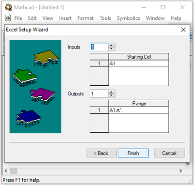

Hi Raiko,
(real) Mathcad, or Prime?
Excel file:
Mathcad:
Mathcad Prime unfortunately.
To explain: I'd like to insert an existing Excel file with multiple sheets as an embedded Excel component in MC Prime. I know I can copy and paste from the existing to the embedded one, but I'd like to avoid such tedious work.
