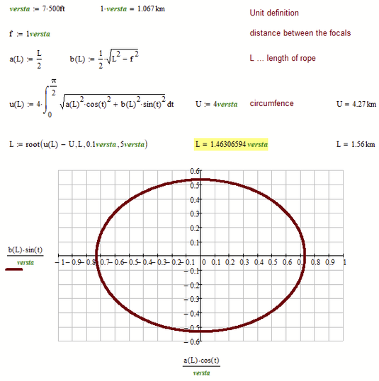

Guess you know that you can't expect a symbolic solution, do you?
Quite a long rope for the time
Thanks, Werner!

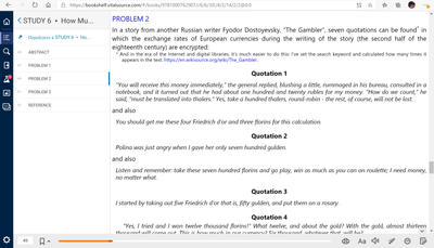

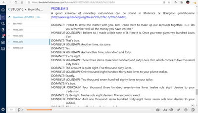

One interesting article about math and not Leo Tolstoy but Fedor Dostoyevsky

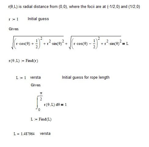

Here's a more long-winded approach than Werner's. It produces a slightly different result.
Hmm.  I tried to post another solution, but had an email saying it was rejected by a moderator.  Any idea why? (It contained a jpg image).
I'll try just attaching the (M15) file instead.
My approach was more long-winded than Werner's and produced a slightly different result.
Alan
Are you sure about the formula for the arc length?
Shouldn't it be rather that way:
The difference to my result is now about 1.7*10^-6 % which seems acceptable to me.
Because the Integral uses the derivative of a solve block function, calculation is very slow and a lot of numeric round-offs may sum up.

Thanks Werner, you might be right about the distance, I did it rather quickly, without too much thought - I'll think on it more deeply!

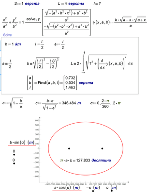

My solution
But it was not an ellipse - if was an oval or 2 lines + 2 arcs.

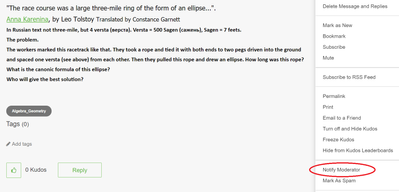

@AlanStevens   No worries!  I can dig into the platform templates and try to find it 🙂  Also, if you are uncomfortable with your post (now visible) AND in the attachment on the second post, we can delete it instead of releasing it from "spam jail" for you.  It kind of helps the flow of conversation when people don't have to click on the attachment to see it, but just use "Notify Moderator" on the post you would like to suggest the Moderator delete.

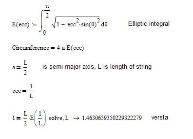

Thought I'd have another go (and also see if I can upload images yet!):
Alan

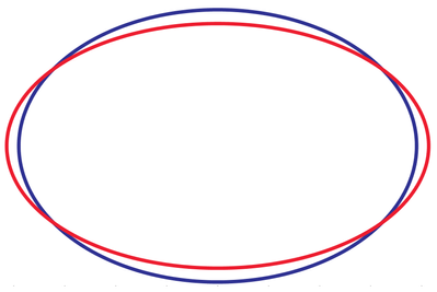

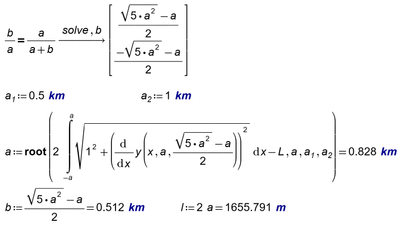

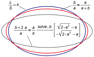

Solution of new problem - not S=1верста, but Gold Ellipe!
9-Golden.pngRed - a gold ellipse, Blue S=1 verstaRed - a gold ellipse, Blue S=1 versta
