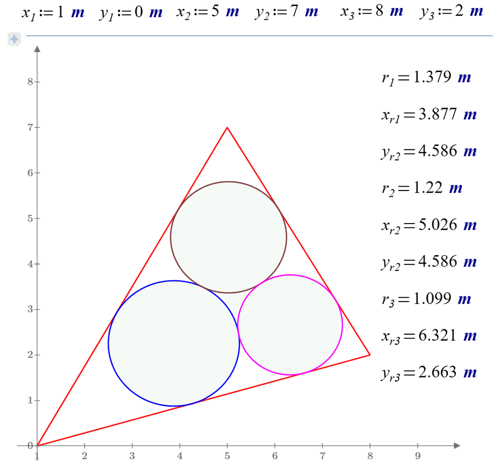

I have solved the
Problem of Malfatti circles
with Prime 6 or Mathcad 15 - see pls attach
Can you solve it more sort, more nice 😉

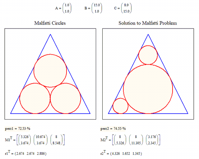

Here you can compare the percentage of the triangle area covered by the Malfatti circles and the true solution of the Malfatti problem (maximum covered area by three circles). It demonstrates that the Malfatti circles never are solutions to the Malfatti problem.
Super! Can you show Mathcad-sheets? I will do it too.
And what about a tetrahedron and three spheres?

Sure, there is nothing confidential or secret in my sheet.
Here you are. The MC15 file is attached. Have fun!

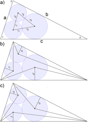

I solved with students the problem of how a triangle fits into a circle using numerical methods - see animation above. The idea came to inscribe two, three, etc. circles in a triangle. The problem was quickly solved numerically (see pictures bellow and Prime 6 sheet in attach). Then we began to search the Internet for this topic. It turned out that our solution is much simpler and more beautiful than the existing solutions.
Compare, pls, with this for example https://mathworld.wolfram.com/MalfattiCircles.html .
Conclusion: first try to solve the problem yourself, and then check if there are already ready-made solutions.
Many decisions were made at a time when there were no means of numerical problem solving.
Nice approach, but personally I'd prefer an exact analytical (and preferably symbolic)  solution over one found by numerical methods - I would consider a symbolical solution more "beautiful" even if it takes up more space and looks ugly at first sight. After all it would quickly give you a simple numerical result as soon as you feed it with numbers 😉
Unfortunately Mathcads symbolic was not powerful enough to give a symbolic solution starting with the very nicely derived equations of Wolfram Alpha.
And of course I also tried to solve your system of nine equations symbolically, but as expected there was no solution found.
The solutions you can find on the net either strive for a constructive, geometrical solution (I would not have been able to come up with any of those solutions I have seen) or an "exact" symbolical one. It looks like you have to accept some tricky detours to arrive at a general solution.
But symbolic calculations always have their narrow limits - just think of real world (systems of) differential equations - just few can be solved exactly.
And as already written above, I think that in generalizing to six circles, numerical methods are probably indispensable.
