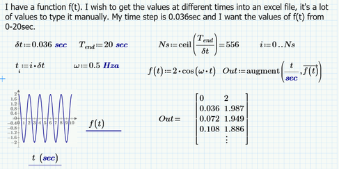

Hey! I'm trying to do the same here, but it's not working.
I have a function f(t). I wish to get the values at different times into an excel file, it's a lot of values to type it manually. My time step is 0.036sec and I want the values of f(t) from 0-20sec.
Can u help me!
Try this:
thank you so much sir. This worked.
