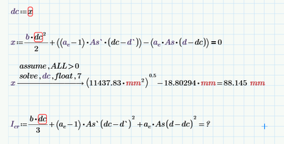

can you help me, sir, for solving this problem, I want to solve (Icr) term?

Last equation. After you can solve dc, then put the answer to dc.
Unit of right first is m^2, second and third are m^4. So can't solve.

You should ALWAYS attach the Mathcad/Prime worksheet, not just a picture.
Apart from that:
- In the definition for Icr, you should explicitly type a multiplication symbol   *
        between As' and (dc-d)
       as well as between As and (d-dc).
If not As' and As are considered functions.
- If you only need numerical results, you should use the root function, or a solve block, to determine the value of dc.
Note that the symbolic processor of Mathcad/Prime does not 'know about units' by default.
But first: attach your worksheet.

A single reply (with attachment) will do...
Please see attached Prime 7 file with comments.
