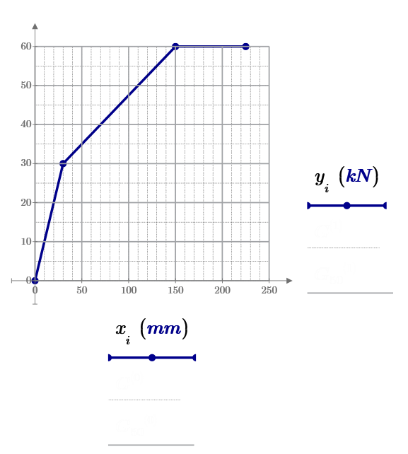

I have the following relatively minor problem with Chart Component axis.
If I let Mathcad to select axis values automatically, the maximum value doesn't show in the graph at all. If I set the maximum value of the y-axis to be 10% higher than the largest y-value, the axis values are no integers, but have decimal values as well.
Is there some way to set axis values automatically, in a way that the maximum value would be shown in the graph, but also the numerical values in the y axis would be integers?
In the attached sheet, there are three graphs. The first shows how the graph is shown automatically, in the second graph maximum value to y-axis is set, but as noted the y-axis values are not integers.
The third graph shows how I would like the graph to look like, but I would hope that Mathcad would produce this kind of graph automatically without manual selections.
This should work too:
I admit, it is a pretty complicated way to do it, so I made a feature request a few days ago.
