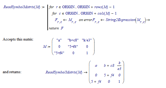

Consider this function:
As you can see, it is possible in Mathcad,
BUT... you need Mathcad 11.
It is the only version that has a sufficiently large undocumented access to its symbolic processor, allowing the String2Expression() function to operate by its name.

You're not the first to ask, and probably not the last either.
