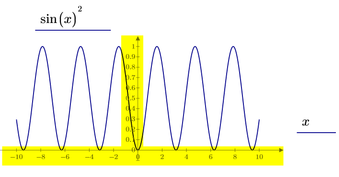

Is there still no way to set the plot font size in mathcad Prime 9

I assumed that @CDMAcat  was talking about the axis scaling of Primes native 2D plots
Yes, that is exactly the question I have. I should have put that in the subject line
As I already wrote there still is no option to change that font size in Prime 9 and I guess its not on PTC's todo-list either.
Thanks for the response, but it missed my question. I want to know how to change the font size of the axes of the plot
