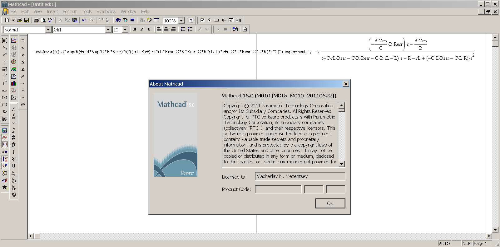

Hi Valery,
You wrote a code that translates string to Equation that works for MC13. I need very similar code for MC14 or later editions with MuPAD symbolic engine. Please see my reply to Michael Hackner above for an example equation in string format.
Ekrem.

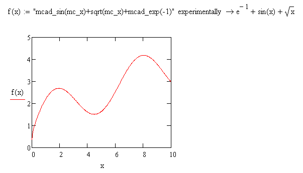

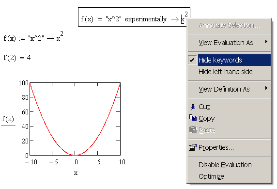

This is possible only if you add a prefix to all the names of variables and functions like here:

P.S. Once more example.
keywords::keyword_experimentally := proc(expression)
local var;
option hold;
save optionExperimentally;
begin
checkKeywordArgs("experimentally", args(0), 1);
optionExperimentally:=TRUE;
var := coerce(expression, DOM_STRING);
// var := stringlib::subs(var, "_22_" = numlib::fromAscii([22]));
eval(text2expr(var));
end_proc:
For MC15 it works without mcad_ prefix for functions:

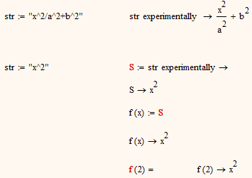

So text2expr() will be good for displaying an expression only?
If a real function is demanded, it had to be hardcoded in keywords.mu like your sin(x)?
I guess there is no doc available.
I've updated the post above. Not all that bad. You need to change only the names of the variables (MC15).
