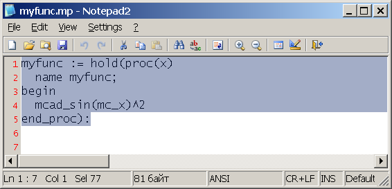

This works for Mathcad Prime 2.0 too (and may be for MP 3.0).
keywords::keyword_experimentally := proc(expression)
local var;
option hold; // N.B.: DOES NOT EVALUATE ITS ARGUMENTS
save optionExperimentally;
begin
checkKeywordArgs("experimentally", args(0), 1);
optionExperimentally:=TRUE;
var := coerce( expression, DOM_STRING );
result := text2expr( var );
eval( result );
end_proc:
keywords::keyword_experimentallyTagged := proc(tag, expression)
begin
eval( result );
end_proc:
I tried to convert the old program of Tom Gudman in Prime, but not everything works. Maybe someone will finalize thin program.

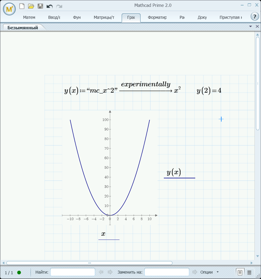

This code is out of date. First, it is too bulky and slow. Second, it is numerical. Try this one better.
begin
if mcutils::isString( expression )
then
unknownslist := mcutils::unknowns( result, All );
for u in unknownslist do
str := expr2text(u);
// Add functions names here
if str[1] = "_" or bool( str in { "sin", "cos", "tan" } )
then
// do nothing
else
result := subs( result, [ u = text2expr("mc_".u ) ] );
//fprint( Text, "log.txt", result );
end_if;
end_for;
else
var := stringlib::remove(var, "mc_");
var := stringlib::remove(var, "mcad_");
var := stringlib::subs(var, "_3A__3A_" = "::");
var := stringlib::subs(var, "_5B_" = "[");
var := stringlib::subs(var, "_5D_" = "]");
var := stringlib::subs(var, "_28_" = "(");
var := stringlib::subs(var, "_29_" = ")");
var := stringlib::subs(var, "_7B_" = "{");
var := stringlib::subs(var, "_7D_" = "}");
var := stringlib::subs(var, "_2C_" = ",");
var := stringlib::subs(var, "_5F_" = ".");
var := stringlib::subs(var, "_20_" = " ");
var := stringlib::subs(var, "_24_" = "$");
var := stringlib::subs(var, "_2F_" = "/");
var := stringlib::subs(var, "_5E_" = "^");
var := stringlib::subs(var, "_2A_" = "*");
var := stringlib::subs(var, "_3D_" = "=");
var := stringlib::subs(var, "_2B_" = "+");
var := stringlib::subs(var, "_2D_" = "-");
var := stringlib::subs(var, "_3A_" = ":");
end_if;
eval( result );
end_proc:
And the result:
I'm still fascinated by the posibilities this window to the MuPad engine could open.

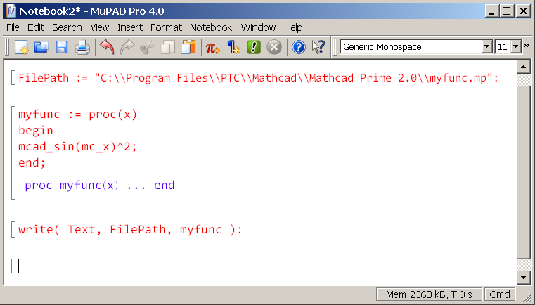

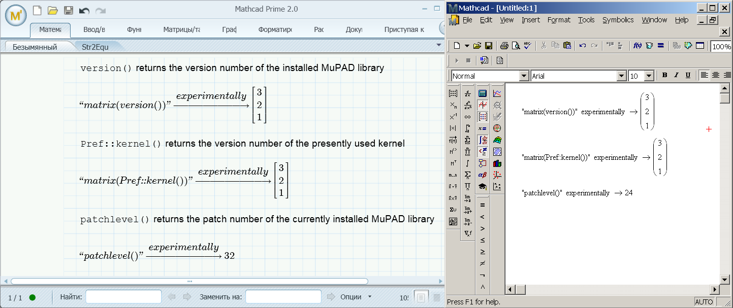

There are a lot of functions. To use them, you must first install MuPad and try them there. But their use is different for MC15 and MP2 (MuPad Prime 2.0)
Thanks for your reply
Oh my god, whats that again in the pic in the Prime window? They didn't change the engine, but it looks like they have changed the interface!?
Вячеслав!
По какому адресу с Вами можно связаться?
PTC use the same symbolic engine as for the MC15.
You can load functions from MuPad files.
