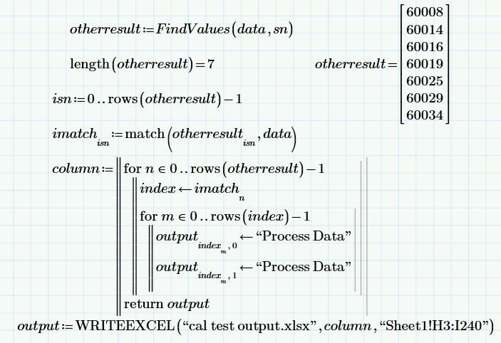

I take it back,  The data presented in the first set of data on 24/03/2020 is different in B.  On 24/03/2020 all values of A exist in B so my use of the match command works.
The second data set on 24/05/2020 only some values of A exist in B.  So before use of the match command each time you need to check A is in B.
You can use match safely with any number in "otherresult"

Hi Terry,
      Thanks for the reply. This is not working because, for imatch, it is telling me no matching values found. That is why I said in my initial post that the match function does not seem to be working in this case and I am not sure why. Kindly check attachment.

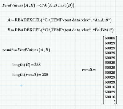

I am irritated by you writing "in the same order". Does this mean that 60016 would be not in the result list because it appears in A BEFORE 60029 but in B just after 60029 ?
What exact result do you expect using your test data and why do you post an excel sheet and not a simple Mathcad sheet with the two matrices already included? Would be easier to deal with.
LucMeekes
(To:arnair81)
The attached worksheet does what you ask (per your description): It checks all values in B, compares them with values in A and outputs only those values of B that are also in A, in the order in which they appear in B.
Given your data, it is now (also) checked that ALL values in B do in fact occur in A.
Is this what you want?

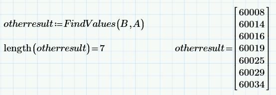

For clarity, if I add 2 to all values of B, some of those sums will not be in A, the result is a smaller list:
