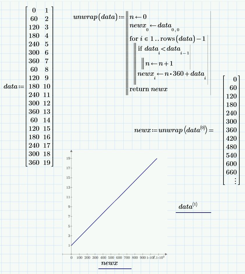

I am using Mathcad Prime Release 5.0
I have data where the first column is angle theta that makes ~5 revolutions (0 to 360 degrees) and a second column that corresponds to a 'y' value. I would like to graph the data from 0 to 5*360 degrees (0 to 1800 degrees on the 'x' axis). Is there a function that will allow the theta data to get adjusted? MATLAB has a function called "unwrap" that would be similar ("unwraps the radian phase angles in a vector"). Note: The angle theta is captured experimental data with some variation in the rate (i.e. there is a new data point ~every 2 to 3 degrees).
1 ACCEPTED SOLUTION
Have made up some sample data.  I think the unwrap program listed here is  what you are after?
If in radians not degrees you will need to adjust.
It is Prime 7 so someone may save it back for you.
It does not take long to type in the unwrap function.
Cheers
Terry
Cheers
Terry

Terry,
Thank you for the solution....that is what I was looking for!

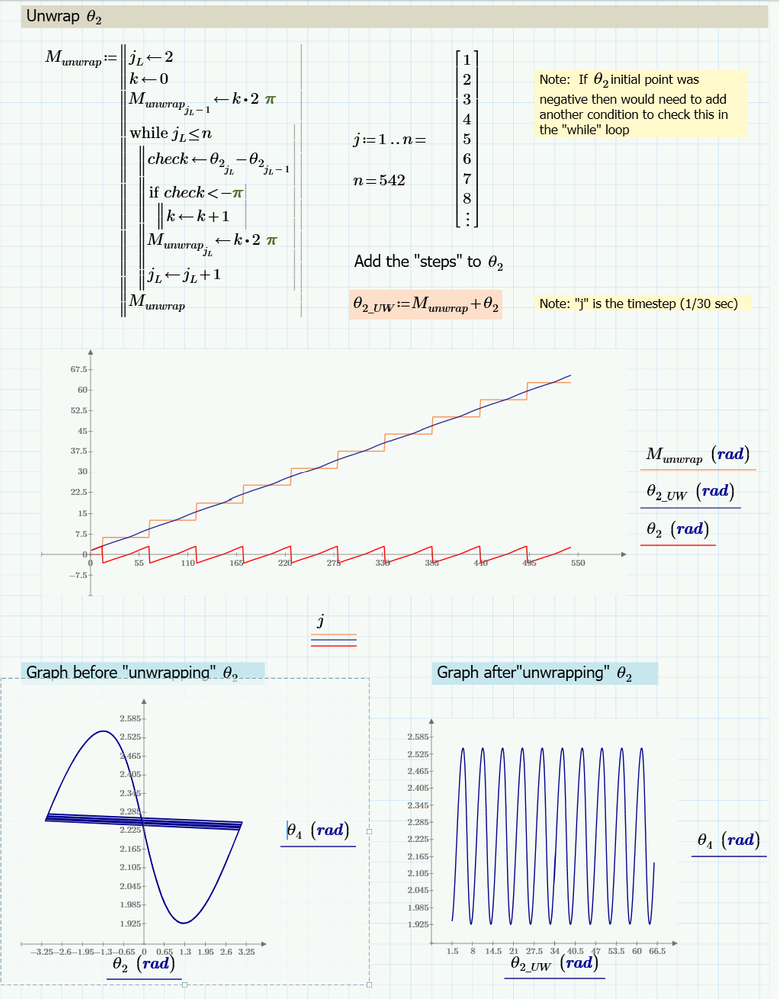

For reference, below is a method a coworker sent over, but your solution is more elegant since it does it in a single step.
Note:  The matrix origin is 1.
In the future I will make sure to supply additional data.

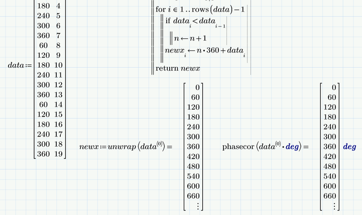

I guess the easiest way would be to use the built-in function "phasecor".
Of course the argument vector has to be a vector of angles. Here is Terry's example using phasecor
QV_8300850
(To:Werner_E)
thanks!  That does work well.
