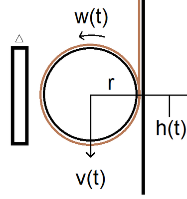

I would like to create the digital double of  the yo-yo toy
Were is my error? See please attachs MC15 & Prime 5.

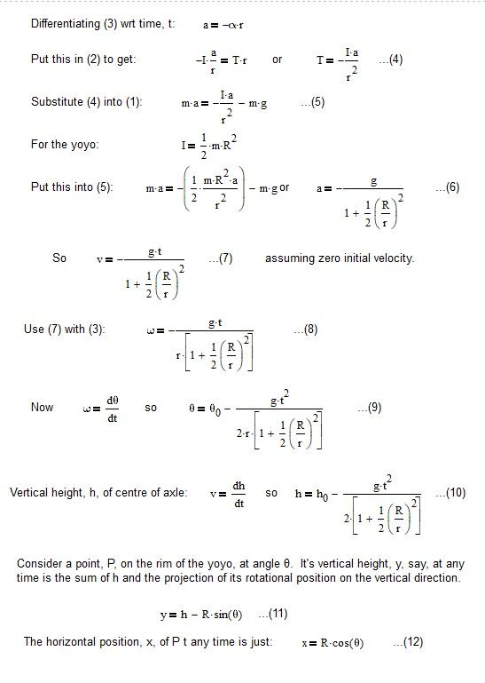

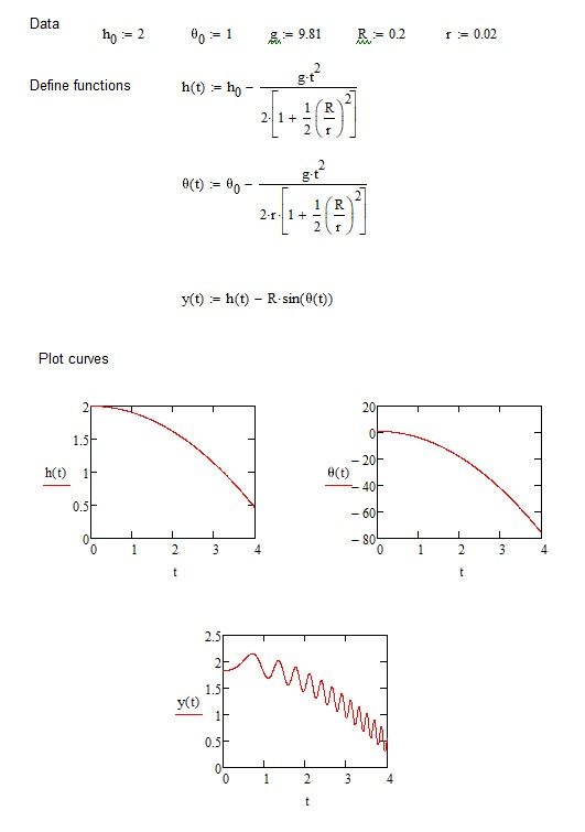

Hmm!  I'm not sure I like your yoyo Val, so I've come up with one of my own!  See below and the attached (M15 version):
Alan
I know! I know! I haven't included units.  I haven't provided an animation.  I haven't done the upward movement.  I'll leave that to whoever is interested!

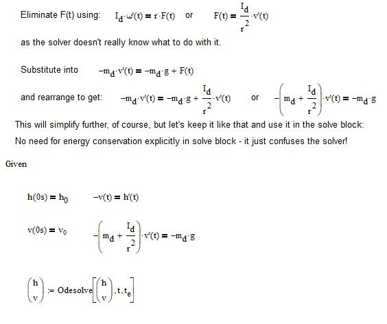

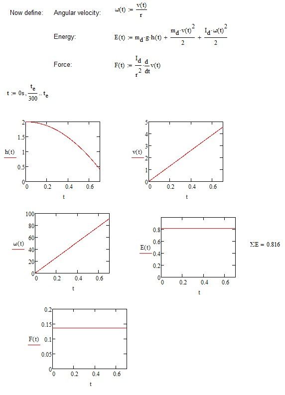

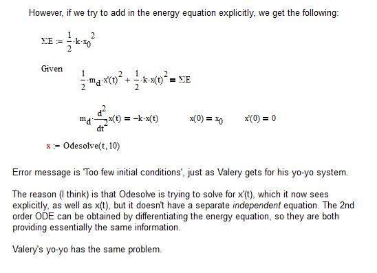

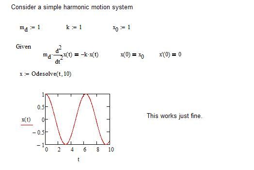

Ok Val, I've modified your worksheet so that it works.  The solver was confused in particular by F(t) and the explicit inclusion of the energy equation (which is there implicitly in the other terms).  See my modifications below, and the attached for the complete file (M15).
Alan

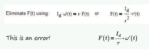

Just one correction:
Not sure I understand Fred:
Alan
Sorry!  I missed your substitution.  You (and Val, it seems) both assumed the string was wound on the outside of the yoyo.  You made no mistake, it was my omission.  What happens if the axle of the yoyo is much smaller than the outside of the yoyo?
Fred,
See my earlier reply above (reply number 9 I think), where I develop a model with the string attached to an axle.
Alan

I've been thinking about this a little more.  My previous replies were too glib (i.e. wrong!).  I now think the problem is as follows:
Alan
