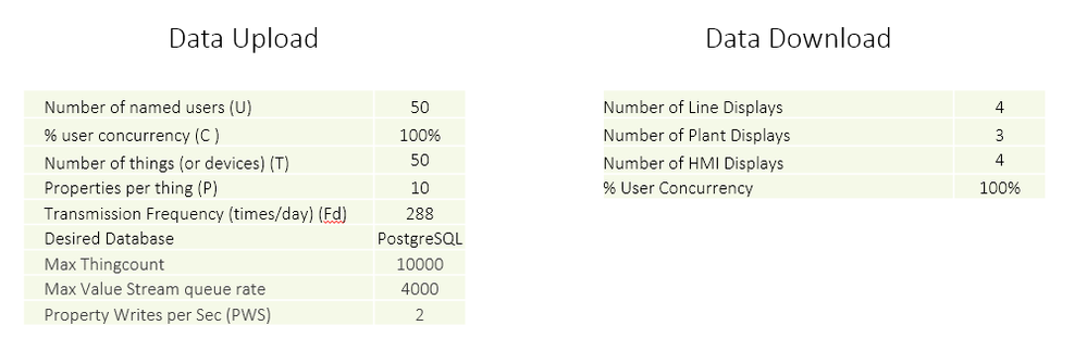

Hi Developers,
I have a use case where i have 50 assets and from each asset i'm going to configure 10 data tags. Also the data tags from Kepware will be visualized in 6 TV screens and 4 HMI Tablets.
So how can i calculate how much internet speed (upload and Download) is required for the above mentioned use case?

it depends on the frequency you want to update the data.
Here is the sizing guide for Thingworx, this may help: https://www.ptc.com/support/-/media/BC2F28281E4142AFA6FC79EC49D9DBD3.pdf?sc_lang=en

Thanks for the quick revert. The transmission frequency is once every minute for upload (From on premise kepware server to the cloud hosted Thingworx instance). The mashups refresh at least once in every 5 minutes.. I am looking to calculate the internet bandwidth (Not storage bandwidth) required. This in summary is the overall requirements
Any help/insights on this would be greatly appreciated.
