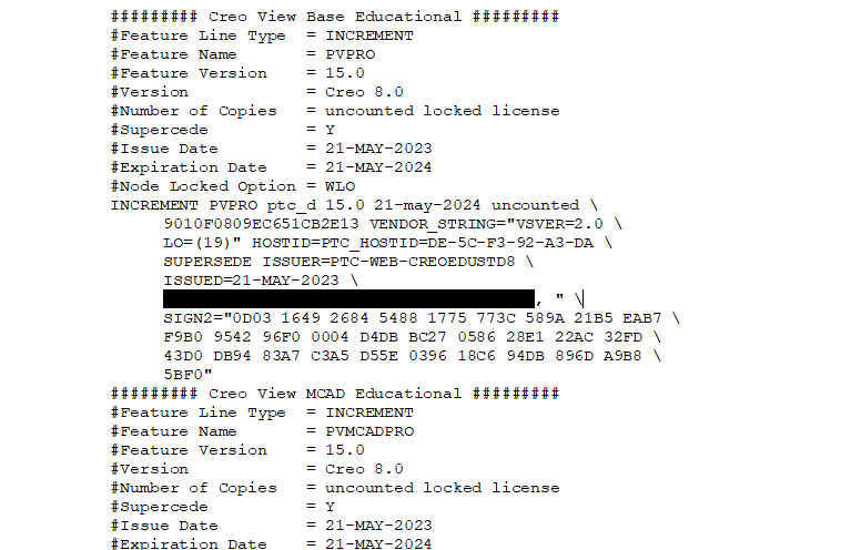

Hi again, I attached ip.txt and licence fill down below. Thanks for helping me
right now, ip.txt contains DE-5C-F3-92-A3-DA on following line:
Physische Adresse . . . . . . . . : DE-5C-F3-92-A3-DA
This MAC address is assigned to Intel(R) Wi-Fi 6 AX201 160MHz WiFi network card.
Network connection has assigned Drahtlos-LAN-Adapter WLAN name.
No Ethernet network card is mentioned in ip.txt. Probably your notebook does not have RJ-45 connector.

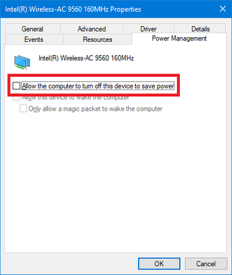

2.] Go to WiFi properties and turn off option highlighted in following picture.
What happens when you disconnect from school WiFi?

I do not have the Option "Power Management" at Wifi properties...
When I am dissconnecting from School Wifi I still get the same warning. Afterwards I get 2 more Errors that says "AFX könnte nicht geladen werden" and "IFX könnte nicht geladen werden" sorry it is in german it means like AFX cannot open and IFX cannot open. But i got these two warnings before too.

1.] Option "Power Management" at Wifi properties
Sometimes it helps to run Device Manager as Administrator:
Sometimes it helps to install newer version of network card drivers.
