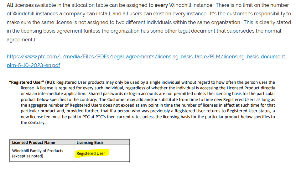

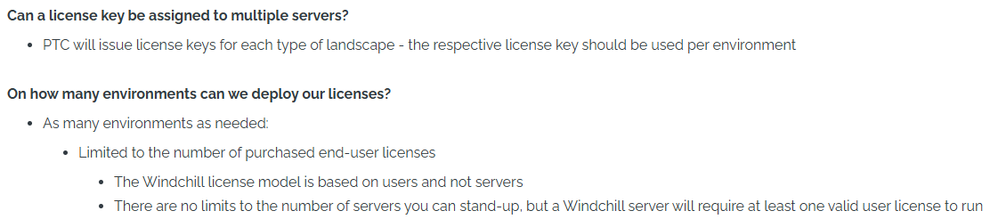

I agree with @StuartHarvey I'm seeing the same behavior.  This new licensing tool appears to be fundamentally broken.  It is treating Windchill licenses like Creo licenses where each license can only be allocated to a single host.  As soon as a license has been allocated, it can no longer be assigned to a different (additional) host.  This is not how Windchill licensing is supposed to work. Windchill licenses have traditionally been 'registered user' licenses, which means they are supposed to be tied to a specific user, but they can be installed on as many different servers as a company may desire, with the expectation that the same user is using the same license across all servers. It's not uncommon for a company to have multiple production Windchill systems - multiple locations, classified and non-classified systems, etc.  ALL of the licenses can legally be assigned to ALL of the hosts, both production systems and non-production systems.  Unless there has been a major change to the licensing model that hasn't been announced, this faulty behavior needs to be corrected immediately (or the tool shut down until it can be.)
A few references:
https://www.ptc.com/en/support/article/CS277468
https://www.ptc.com/en/support/article/CS343070
Solved: Re: Regarding Sharing Windchill Licenses - PTC Community (my own comment in another post)

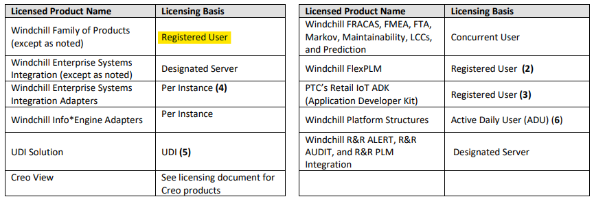

I just checked the current licensing document, and from what I can tell, nothing has changed.  Windchill is still licensed by 'registered user':
It would appear that the developers of this new tool used the 'designated computer' or 'designated server' model, which is completely wrong for Windchill licenses.  Here are definitions of each from that same licensing document:
“Registered User” (RU): Registered User products may only be used by a single individual without regard to how often the person uses the license. A license is required for every such individual, regardless of whether the individual is accessing the Licensed Product directly or via an intermediate application. Shared passwords or log-in accounts are not permitted unless the licensing basis for the particular product below specifies to the contrary. The Customer may add and/or substitute from time to time new Registered Users as long as the aggregate number of Registered Users does not exceed at any point in time the number of licenses in effect at such time for that particular product and, provided further, that if a person who was previously a Registered User returns to Registered User status, a new license fee must be paid to PTC at PTC’s then current rates unless the licensing basis for the particular product below specifies to the contrary.
“Designated Computer” (DC): Where the product name contains the words “fixed,” “locked,” or “node locked,” such products are licensed to operate solely on the designated computer on which they are installed. It is not permitted to move Designated Computer licenses from one computer to another by means of installing such products on an external, portable or removable device (e.g., USB dongle, NAS, Router, memory stick, USB drive, external hard drive) or through other means.
“Designated Server” (DS): Each Designated Server product may only be used on the computer server that is designated by the Customer in connection with the initial installation of the product and that has one unique instance of the applicable installed product application. In the event a computer server is partitioned in any manner (physically, logically or otherwise), the reference in the preceding sentence to “computer server” shall mean each partition of such server, and such Designated Server product may only be used on one of such partitions.

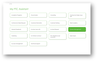

For questions, concerns, or assistance with the above setups, I continue to encourage the use of My PTC Assistant, License Management option to receive direct PTC support for your license configuration scenarios.

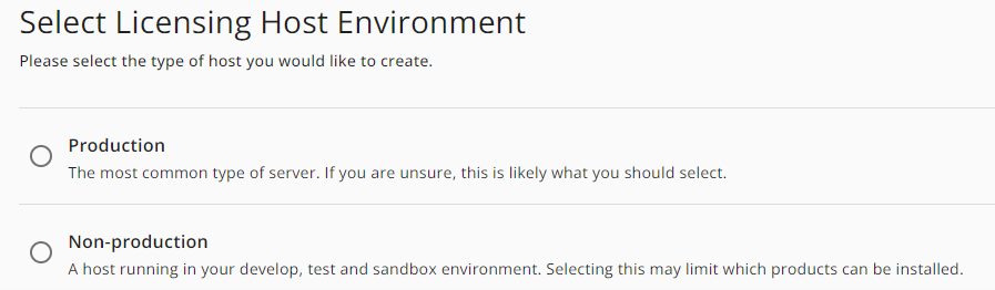

Is there any way to switch a host environment between 'Production' and 'Non-Production' after it has been created?  I've tried editing existing hosts, and don't see any way to change this.
It's very common to stand up new hosts, use them in a non-production way for a while, and then eventually put them into production.  It seems like it should be possible to change this setting after creation.  What do you suggest?  Use 'Production' for everything, or delete and recreate the host each time we need to change the setting?

@TomU We've fielded similar feedback in other forums and are working to introduce a path to migrate non-production to production without reconfiguring the products assigned. We expected the more common scenario was to create a production server and then clone it for use in non-production environments, which is why we made that available first. Our functionality will continue to evolve and become more robust - this was the first release.
For your described situation, you will need to create a production host separately and re-configure it with available licenses or the uncapped setup mentioned earlier. If you already know that you will use this server in production, I recommend creating the initial host as a production host. You have the option to clone it with a non-production designation or just use the host as configured in a sandbox until you are ready to call it production. The designation for production vs non-production was to assist with multiple environments without impacting installed quantity.

Our Support team is not only available for issues, but also available to help you with your questions about the new tool as you get accustomed to the new features. If anyone would like a direct conversation with our team, you may request that assistance through My PTC Assistant and selecting the License Management option.
