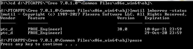

HI Guys,
We currently run Creo 3 m090.
We are also in the process of testing out Creo 7
can someone explain how to return borrowed license files from each Creo 3 and Creo 7?
When I try and return them, I get an error saying that they are borrowed from multiple VD's, and i need to specify which.
How do i do this?
Here is what my return script looks like.

After I run this, I still show 2 PROE_EngineerI not returned.
The one that sets to expire on April 10th is from Creo7
The one set to expire Oct 29th is Creo3
here is what i get for an error when trying to return the PROE_EngineerI

change lmutil lmborrow -return commands according to following example
lmutil lmborrow -return -c 7788@azuse2lic10 -vendor ptc_d PROE_EngineerI

Thanks for the reply.
I tried that, and it still does not work.
If i run ptcstatus it doesnt show me as having any license, but lmutil lmborrow -status still shows the 2 PROE_EngineerI files.
Maybe this isnt a big deal. ??
my suggestion:
  • wait until 30-oct-2020
  • I hope license borrowed until 29-Oct-2020 23:59 disappears from lmutil lmborrow -status output
  • repeat your request to return the second license
Note 1:
I am not sure if it is possible to borrow license for launching Creo 3.0 and 7.0 simultaneously under single user. If I were you I would login as user1 + borrow Creo 3.0 license -AND- login as user2 + borrow Creo 7.0 license.
Note 2:
In case that the problem remain, please run following command from Command prompt window and upload ptcstatus.txt file.
cd <Creo Parametric/bin subdirectory>
ptcstatus -nopause > ptcstatus.txt
Martin Hanák
