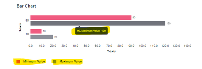

Step 1 : Set 'NumberOfSeries' in chart properties.
Step 2: Provide customized value for 'DataLabelN' to shoe legend in series & hover on bar.
Expected Out:
Thanks & Regards,
Arun C

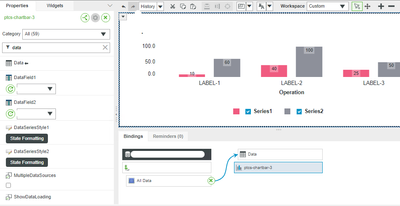

I couldnt see the propert which is showing for you. Iam using thingworx 9.1 version.
Hi @AP_10343008 ,
This DataLabel1 — DataLabel24 will available later TWX 9.1.2 version .
