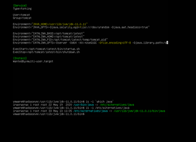

Hi @PEHOWE
It looks like both Java and Java encoding option are set properly in tomcat. Please below image for your reference
Still I don't know why it is not working.
/VR
Hello Velkumar,
From your screen capture it is not possible to verify that the -Djava.library.path variable is pointing to the proper location.  It should point to
-Djava.library.path=/opt/tomcat/latest/webapps/Thingworx/WEB-INF/extensions
Peter
