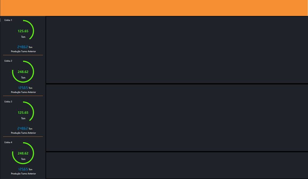

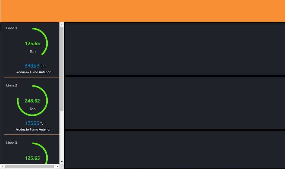

Hi all.
Currently I am working with a new responsive (advanced) mashup because I want to create a responsive dashboard.
In this case, I have two monitors. One with the resolution 1920 x 1080 (20") and other is the notebook with the resolution 1366 x 768 (14").
However, there are widget that does not responsive, so I need put on in front the widget panel and when I to run the mashup and change the monitor the widgets (that does not responsive) widgets don't look right on screen.
I am going to let the mashup's print below to facilitate understanding.
My question is: Is possible to create widgets responsives? If yes, how?

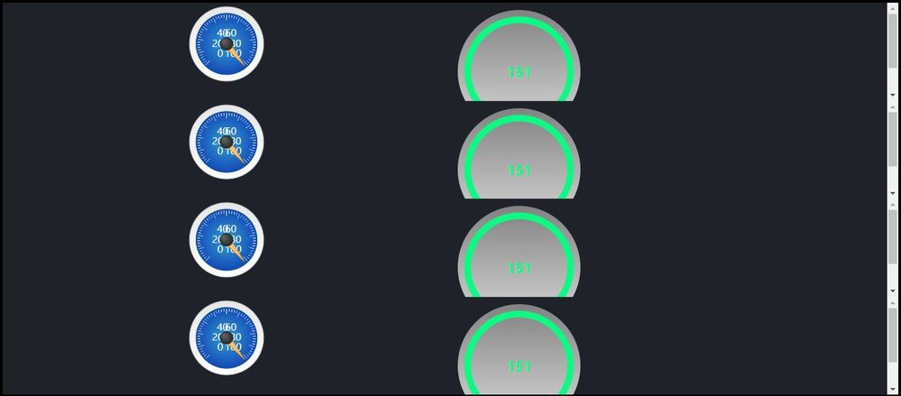

Hi @Constantine
I used in example four Gauges and four Progressives Gauges.
The Gauges are responsives, so it resize.
But the Progressives Gauges are not responsives, it keeping static. I wanna use the Progressive Gauges. What I want to know is: Can I do Progressive Gauges be responsives?
Image below:
@einsfele
If you wish to make the gauge responsive, you would need to create your own widget using the original as a starting point.  Here's another community post that may be helpful.
