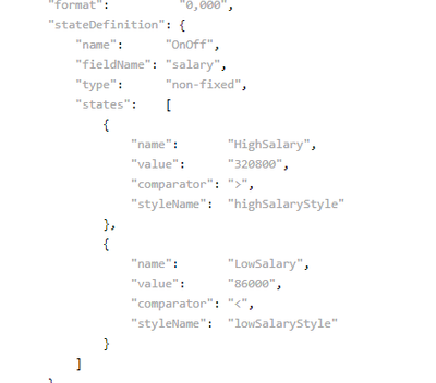

Hello slangley,
I am using ThingWorx 9.3.0-b20. I have looked over the possibility of typos but I managed to replicate the problem using the AdvancedGridExample:
Same question:
