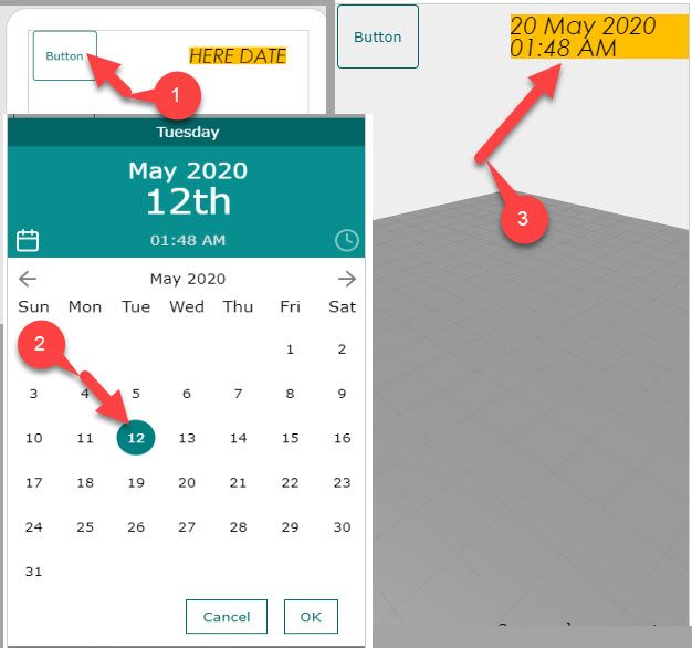

When the picker is closed after date was selected - the javascript code will set the selected value to the text property of a label widget (label-2).
The javascript and the style (css) implementation was copied to the resource folder:
Now the simplepicker could be tested and it has the following appearance in preview mode:
