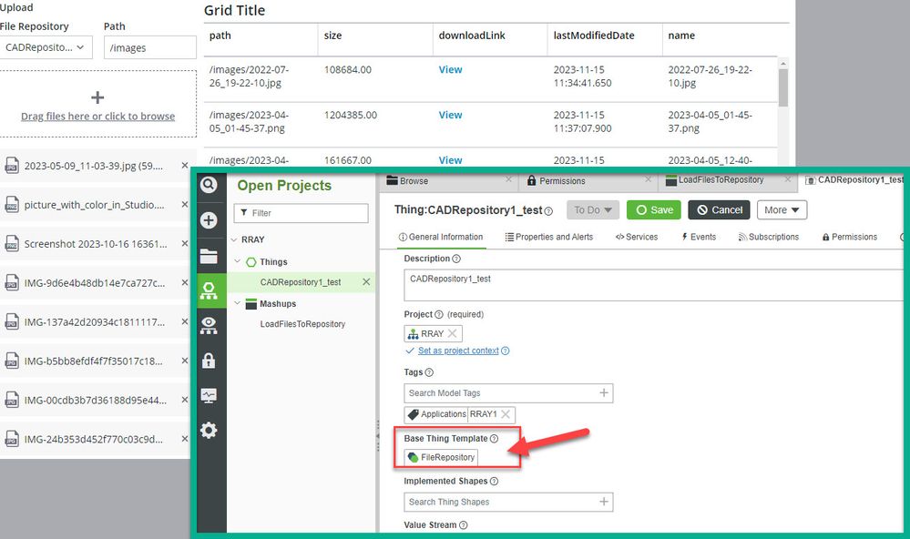

I think the best option when you have a internet connection  is to use a Thingworx repository thing (this is a thing which use the FileRepository template) where you can upload all data (this data could be updated also dynamically to thingworx each time):

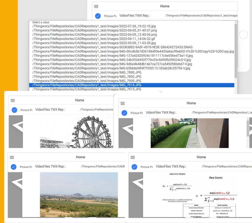

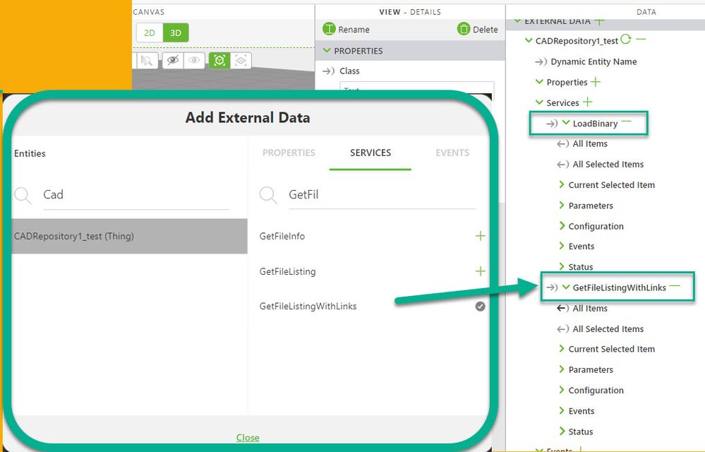

So  you can use a list for the pictures where the list is filling via TWX service GetFileListingWithLinks:
Then this will looks like e.g. in preview mode:
So I  tested also on mobile device and this was working fine, it takes some sometime (1-2 seconds) when I need to load  large pictures and internet connections' to TWX is not so good but the performance for loading of picture's is ok. Possibly when we try to stream  videos this could be a more critical point. I attached the test project here. To test it you need to create your own repository on TWX and add the services as shown on the pictures to the external data section
