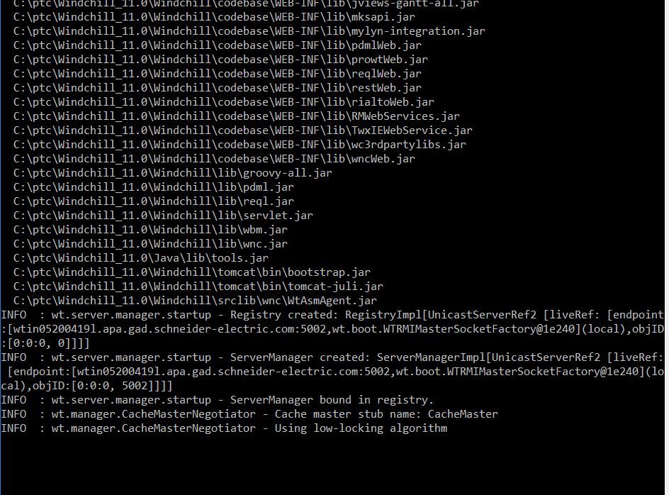

when i entred "windchill start" in the CMD, server manager will stop at this stage and method server will never start , what could be the reason ?

Is Windchill DS started first?
Is Apache/the Web server started second?
Are your vaults enabled?
Any other log file messsages?

Hello Ben
Yes, Windchill DS started first and  Apache/the Web server started second?
how to check if vaults are enebled? i am thring to launch in my own PC

Add some logs :
in WINDCHILL_HOME/codebase/WEB-INF/log4jServerManager.properties.
log4j.logger.wt.manager.ServerLauncher=DEBUG
and look in ServerManagers log file. Look for the command and parameters used to launch the MS

This is strange, I don't see any logs.
It's log4jMethodServer.properties in the zip file, not log4jServerManager.properties, so...

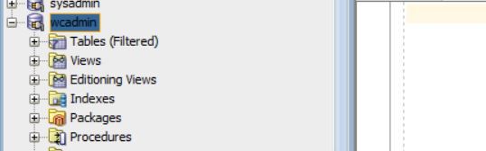

Check the connection to your database.
database is conneting ,
is this the right way to check ?

SergeyEfimov
(To:Gagan)
Check the db properties and the connection by your db user.
