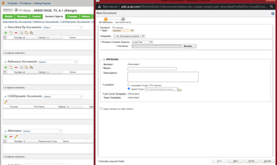

Hi Guys,  I need your help with this.
I have one WT part and I want to add local data, such as Word, TXT, and XML files. In the related object, we have a Described by Document and Reference Document. Right there, we can use that tab to create a new document and attach it.
Here, I want the name and number that I gave in the WT part to be the same as the ones in the WT document. It's possible.

Hi @Amirtharaj_K,
Do you want to see name and number of document same as part on loading of new WTDocument wizard?
or
its okay to have same name and number after creation of WTDocument?

When we create a WT part i am using Name is Test and Number is 0001 when i create new document in reference document tab or described by document tab i want a same name Test and number is 0001.
AJ
@Amirtharaj_K
That’s a tricky one for number as there is no guarantee the WTPart’s number is not already used by a WTDocument.
If the Part’s number is already used by a WTDoc what logic would you use for the number of the new WTDoc?

I accept, but I made a mistake and will provide a different name/number. For example, I am only sharing those documents for particular departments, except for others. How can I find it? I need the name or number that is the same as the WT part.
Number - I can provide autonumbering, but at least I want the same name as the WT part name.
Because I am not creating an individual WT document and adding it to the WT Part Right. I directly create a WT document in the WT part. Even though we create it directly in the WT part, the document is saved separately. It's only a link to each other, right?

I have one WT part in which we can see the tab 'Described by Document/Reference Document' Right, there only i create a Document. I want the same name as the WT part name, which is my question. The other features should be the same.

If you need it only for a searching purpose then I would advice to use IndexSearch with solr.
You can put the number to the attribute of the WTDocument and you can search by this number.
btw if you want more documents for same WTPart what would you do then if the WTDocument number has to be unique?
