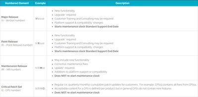

shussaini
(To:BenLoosli)
This is the new naming convention for the releases. Hope this helps.
Refer CS279884 for more details.
