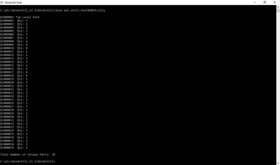

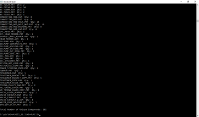

Scott,
Is this what you are looking for?
I wrote a utility that given a WTPart or EPMDocument will go through the entire multi-level structure and sum the quantities of each Part or component in the structure.
Once you have the information where is it going?
Do you use it for something that is done in Windchill or is the data passed on outside of Windchill?
How do you want to trigger it? Do you key off an event or just whenever run it manually?
The utility could be expanded to write the output to a files and even attach the file to the top level object.
An action could be added to the WTPart actions menu that could be used to trigger the utility as well.
For ease of reading the output is sorted.
When run from Windchill the output is Number Qty and looks like this.
CAD Structure has skeleton models excluded.
Part Structure
CAD Structure
