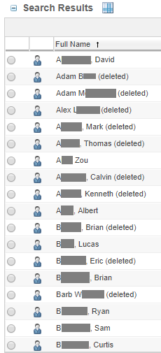

Deleting a user from Windchill doesn't remove all trace of them from the system.  Their entry in the WTUser table continues to exist, but they are no longer linked to an LDAP account (Windchill DS or Active Directory), they no longer have a personal cabinet (think workspaces), and they cannot participate in workflows or be a member of a group.

The names still show up in the user interface, they clearly show deleted and you can still search for them and use them in Advanced search etc. An added bonus is that they cannot receive any new tasks in the system.
The only weird thing is that upon deletion the username is changed;
"lewis" would become "{wt.org.WTUser:XXXXXXXXX}lewis" where XXXXXXXXX is the internal database ID for the user account.
This also means (I think because of the curly brackets) that to search for the user you have to use wildcards; "*lewis*" would return the account above after it has been deleted, but the full txt above would not. Only a nuisance if you need to search up the user for an advanced search or similar.
If you have a test system you could easily do some experimentation.

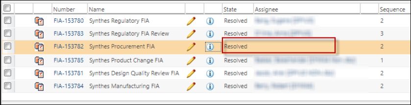

With regards to not deleting users, we have found and issue where deleting the users leaves resolved tasks blank in our custom Impact Assessment within our CR process, which is not acceptable in our environment.

Regards your custom impact report "losing" the user details, I suspect you need to review how you are returning the user for that report. The user object is still there, just marked as deleted and is probably being filtered somehow when you don't want that.
