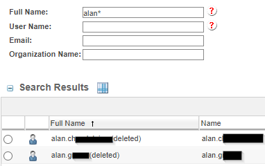

I think they fixed that. In 12 at least you can search on delete users.
If you delete a user from database and directory server, you can't find them in search.
avillanueva
(To:SC_8321054)
I do not think that is true:
You cannot find them in participants search sure but you can find things from them like created by and modified by. They show up with (deleted) next to names.

okay, so if I chose option "delete from Windchill" I still could able to find the user in search but if a chose "delete from Windchill and directory server", the user is gone completely.
