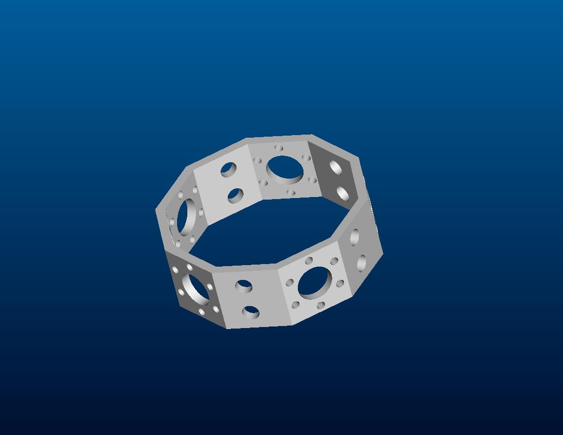

Copy/paste group of holes

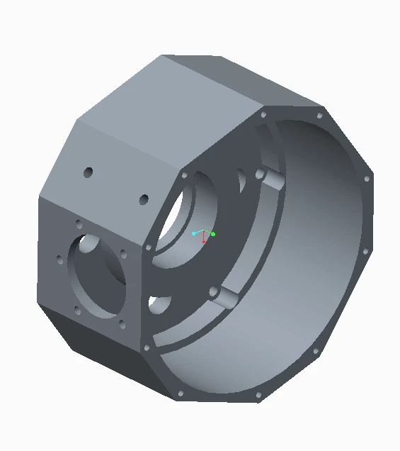

I am designing this radial engine (see image), and have to put in the holes for the cylinder heads all around the crankcase. As you can see I have put in 8 of the holes, but I have to repeat this process 4 more times for a total of 40 holes. Is there an easy way to copy the holes in groups and move them to the other faces? For example take the group of 6 on the left face, and copy them as one unit. Thanks

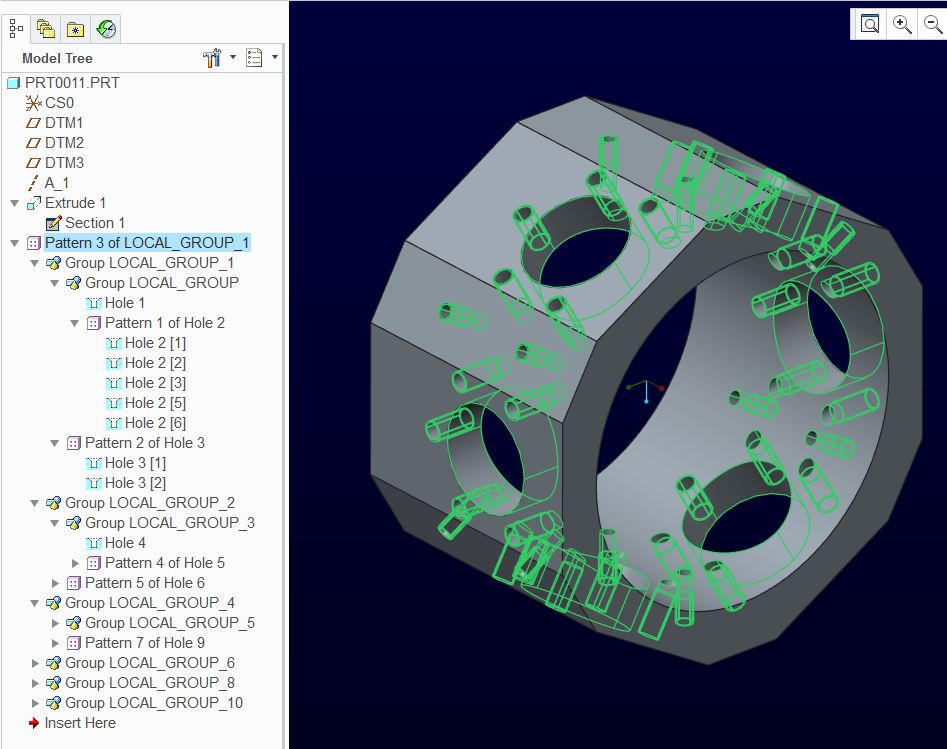

    Jan 10, 2013 7:59 AM UTC
    This might give you an idea of how these were grouped and patterned: This is Creo/Pro 2.0
    Center large hole grouped with patterned bolt circle (5x)
    Linear patterned side holes (2x)
    Grouped holes from both faces
    Patterned group (6x)

    Wow, thanks guys, this pattern feature is really neat! It worked excellently.

    Of note, you can create a group and pattern it as mentioned, or you can "reference" pattern the smaller holes to the large hole. This allows a little greater flexibility.

    I think the reference pattern gives more flexibility, as if you have a group of 5 things to pattern, you can delete one of the middle ones an not have an issue, whereas you'd have to delete the patterened group, then ungroup, delete the feature, then regroup, then re-pattern.
