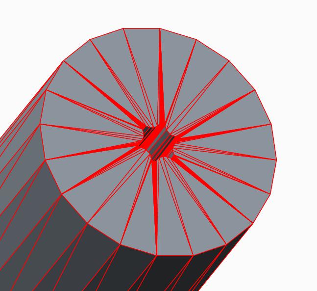

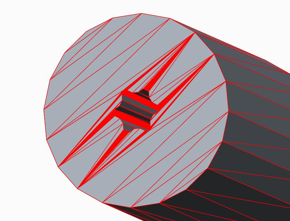

I make a lot of STLs for rapid prototyping and for fea, I want the stl triangles to be arrayed around the center of circular flat surfaces, the way they are when created in DEFORM (http://www.deform.com/).
The only way I have now, is to make all the surfaces either slightly concave or convex. Which works, but sometimes causes issues with the models.

    From my many year of rapid prototyping, the triangular pattern on circles have typically been like your picture on the left irregardless of software. I am not sure how the algorithm is written for developing the triangles. If you change your resolution sometimes it will modify how the triangle are made.

    The only reason I really care, is that in the fea program DEFORM, the mesh is created from these stls and the pattern on the end faces make the mesh behave poorly; which is the reason I do the models with concave/vex surfaces.
    The DEFORM software makes stl models like the picture on the right, but I think everything is considered a simple revolve, so that is most likely the reason.

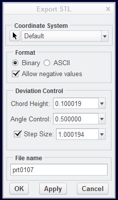

    See how the VRML export does the faceting. If it is more to your liking, you can then import it again and the STL should now follow the VRML facets fairly closely.
    I have a feeling that the "layering" of the facets in STL is probably intentional as the STL process is cone by layers rather than logical facet divisions. If the above test fails, it is very likely that this is the case and should be considered an enhancement to a generic STL generation.
    Have you looked to see if there are options in the STL export?

    Here's the thing, if it's a flat surface, the triangulation is completely irrelevant. Really. ONLY if there is some curve to a surface will it matter. In your case with a flat surface and the splined hole, only the amount of triangulation where the spline intersects the surface matters, not the look. The flat surface will ALWAYS be flat, it's just how accurate does the curve on the spline need to be, because the amount of segments where it intersects the flat plane is what determines the accurace longitudinally down the splined hole.
    I would NEVER make what should be a flat surface concave or convex simply to make the file look better. The system knows what it's doing, don't worry about it. I've never had an issue and I worked at a place with 2 SLA machines I used constantly for about 2 years.
    I haven't created an STL in creo yet, but there should be (read: WAS) settings you could set for, if I remember, chord angle and chord height. They or similar should still exist, just look for them when you create the STL file.
    Best of luck.
