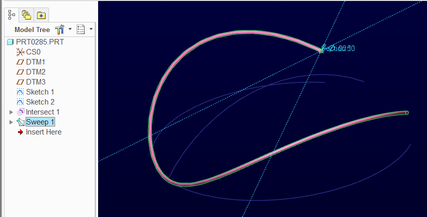

Jan 16, 2014 9:39 PM UTC

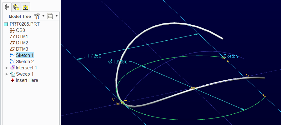

top down curve sketch

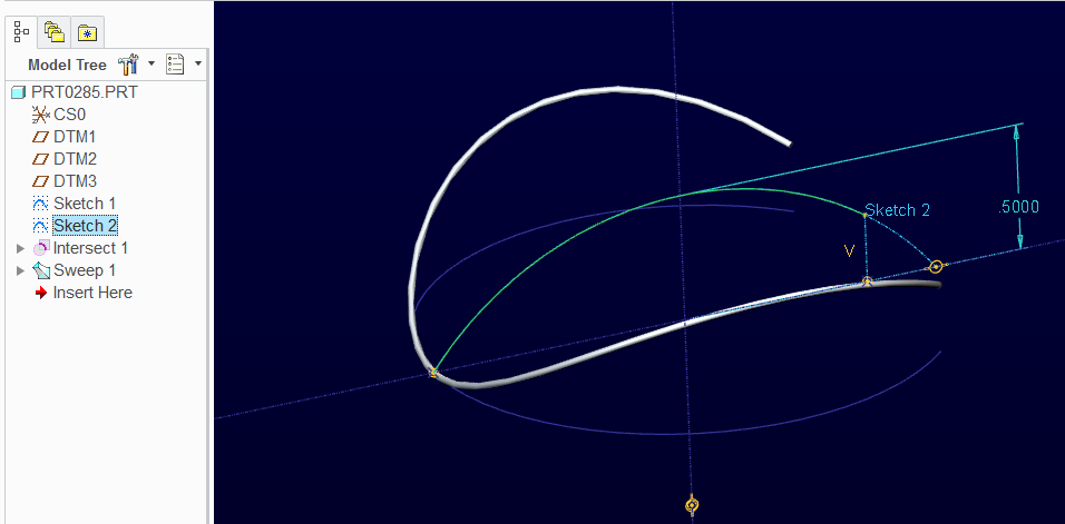

Side view sketch

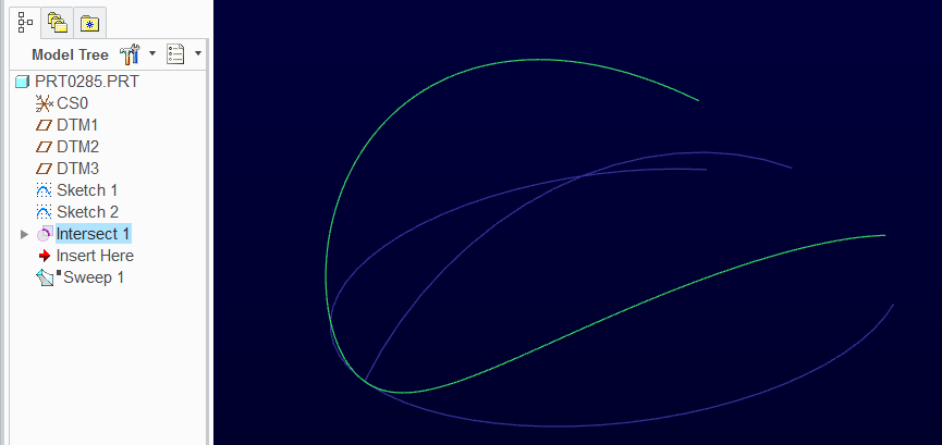

Intersect 2 sketches
Sweep
13 replies

It's a bit hard to tell, but I'd say it looks like two simple sketches projected together. Perhaps a circle on top and a shallow arc on the side.

Swamped right now, but it's fairly simple. Sketch 3/4 of a circle on the top plane, sketch a shallow arc on the right plane (same length front to back) and then use the intersect tool to intersect the two.

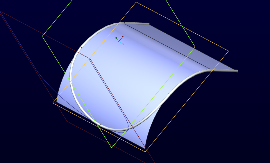

Feb 25, 2014 6:06 PM UTC
The challenge has changed slightly as the 2 free ends are now straight.
This time I used a wrap feature to better preserve the radius.
Creo 2.0 model attached.

The wrap feature is discussed in this video:
Closed and Ground Spring - Alternative to Helical Sweep
You have to be careful about running the ends beyond the surface. If you check both options in the wrap feature, it may ignore it. However, I have also had it fail. I measured the length of the surface to use in the "U" shaped sketch in the included example.

One thing, depending on the desired result, you either want a wrapped curve, or a projected curve. Wrap does exactly that, preserving the overall length of the curve. Project does what Antonius did first with the intersection of two curves, which will stretch/distort the overall length.
