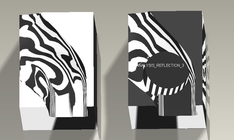

Is there a way to fill the hole?
Hi, In creo is there a way to fill the hole? see the attachment.Thanks!QQ%E5%9B%BE%E7%89%8720141021093908.png

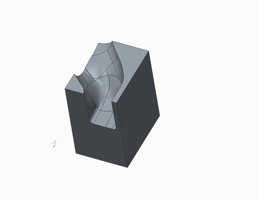

    Sure, but you have to tell creo how to treat the inner volume.
    See one possibility in the attached video.
    Video Link : 5378

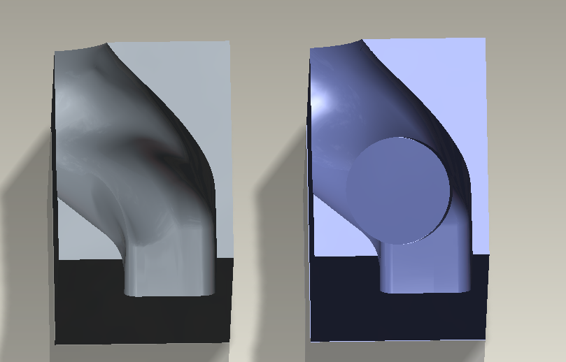

    THANKS! But it looks very distorted.

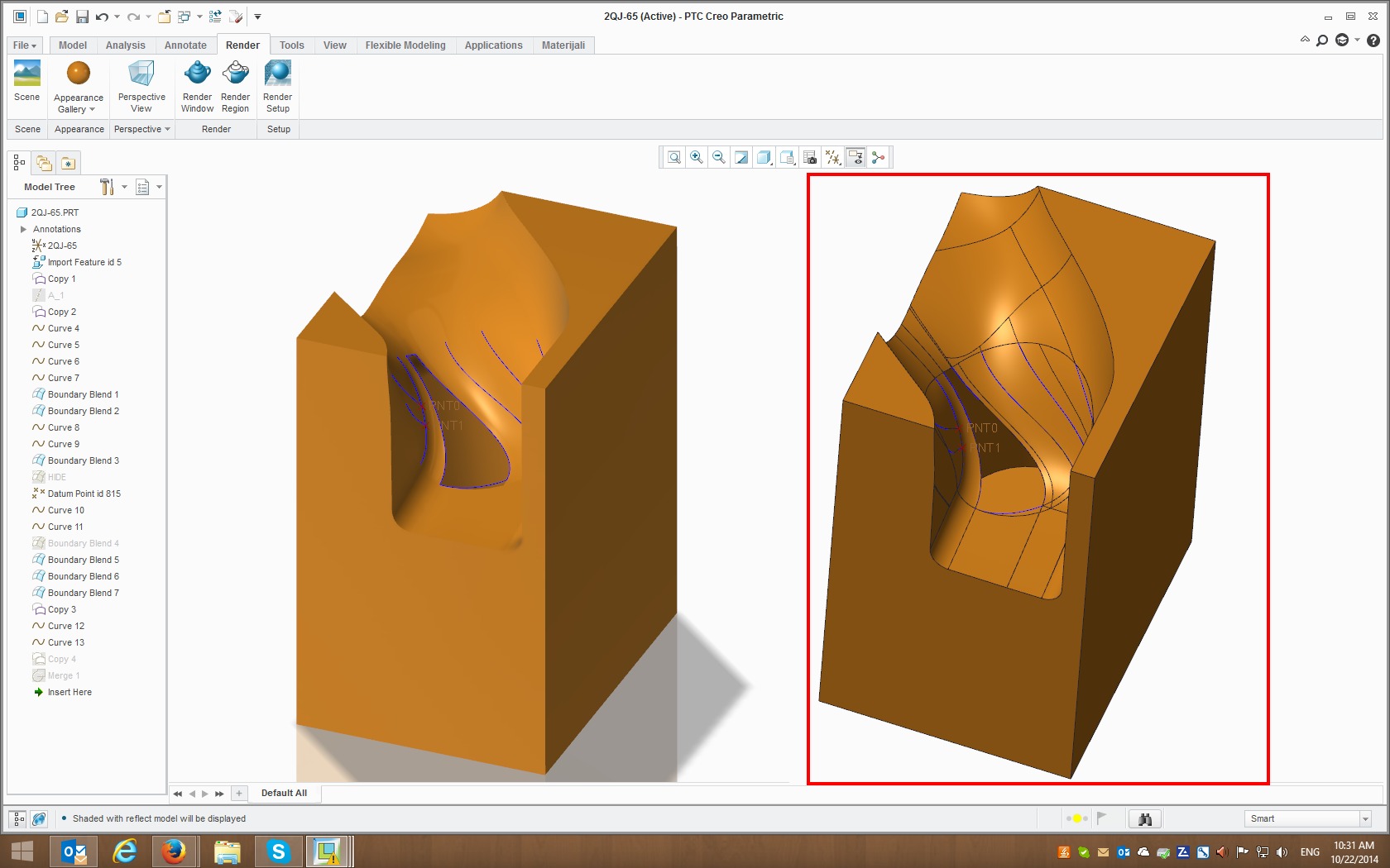

    As written, it depends on what you "tell" creo to treat the inner volume.
    See attached example (not finished).

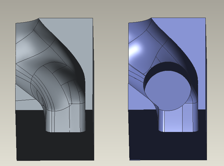

    My attempt.
    Meh, lost my nerve near the end so if you can finish it cool.
    Btw in Creo 3 we can fill holes when copying quilt but not that complex.
    NX fill is real nice but in this case still gives less then perfect fill.

    ok this is done in creo 2.0 student edition.....i have attached the step file also

    But not tangentQQ%E5%9B%BE%E7%89%8720141024152531.jpgQQ%E5%9B%BE%E7%89%8720141024152609.jpg
    Oct 24, 2014 7:41 AM UTC
    consider this as the first step...since creo does not have a specific tool like in nx..
    the good thing is..it took very less steps.

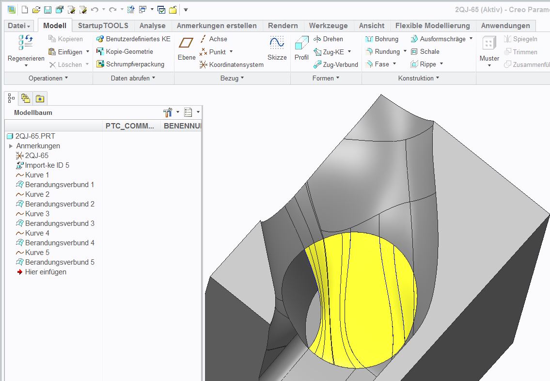

    I have no excellent skills in ISDX module, but i reach a complete filling of entire surface with tangency continuity. I rebuild surfaces. Expecially near the hole, geometry was very poor. IDD isn't a perfect solution. I think that for guys of reverse enginering filling this hole is a joke. Sure it's not a 2 click work as in other software. I attach Creo2 and STEP file. There are little distorsions on my work, but i'm not a specialist.
