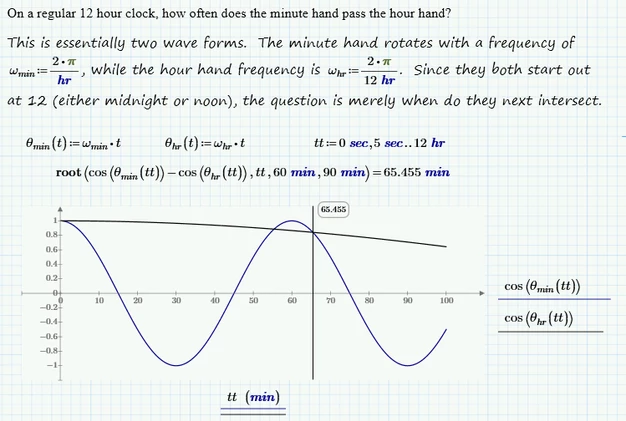

Here is a simple math challenge for you. Solve with MathCAD!
On a regular 12 hour clock, how often does the minute hand pass the hour hand?
(Hint: The answer is not 60 minutes.)
Edit: I'm looking for the amount of time it takes for the minute hand to pass the hour hand.
I will post the solution in 1 week. Kudos abound!
Werner_EAnswer

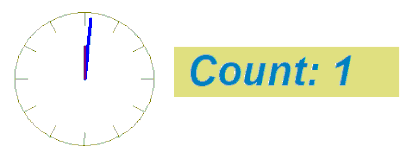

Anyway - challenge accepted. Lets use Mathcad 15 to simply watch and count (and stop before we reach 12:00):

You're correct, but that's not the answer I'm looking for. I apologize for how I worded the question originally. I'm looking for the precise amount of time it takes for the minute hand to pass the hour hand.

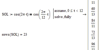

Your reply is missing the actual answer to "how often".
Furthermore only every second point of intersection is a valid solution!
12 of those 23 solutions are not valid!
E.g. the "solution" t = 12/13 hr = 55.385 min corresponds to 00:55:23.077.
At this time the handles do not pass but are mirrored by the vertical
The times we are looking for simply are all multiples of 12/11 hours.

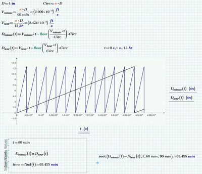

I thought it'd be fun to think of it as distance travelled instead of angle.  Similar to Fred's otherwise.

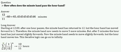

Hello, everyone. Here is my solution. I modeled it as an infinite series and came up with the same results. It was very interesting to see the variety of different ways to get the same answer. Everybody thinks a bit differently, and that's what I wanted to see. Thank you all for participating.
