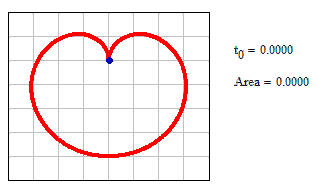

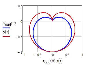

Hello Everyone.
From :
To :
  How to calculate Area of Parametric (closed) Curve, the above ? ( MathCad 15 )
  Thanks in advance.
  Regards.
  Loi

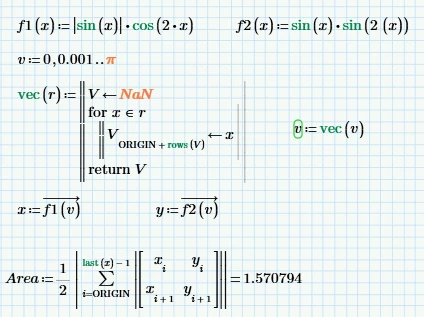

While this problem is solvable with calculus - there are tricks to doing it other ways that can come in handy for other less mathematical shapes.  Shoelace formula (Surveyor's formula) works just using coordinate points.  Something Werner taught me years ago.

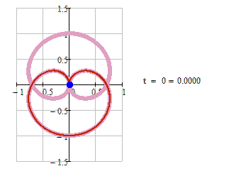

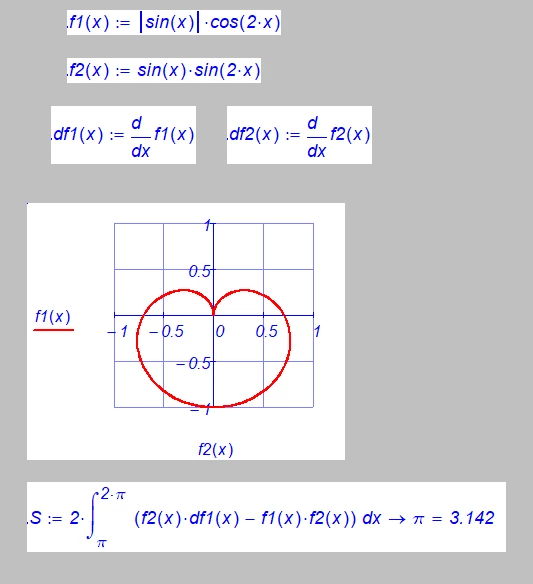

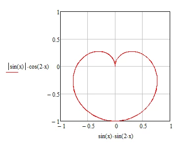

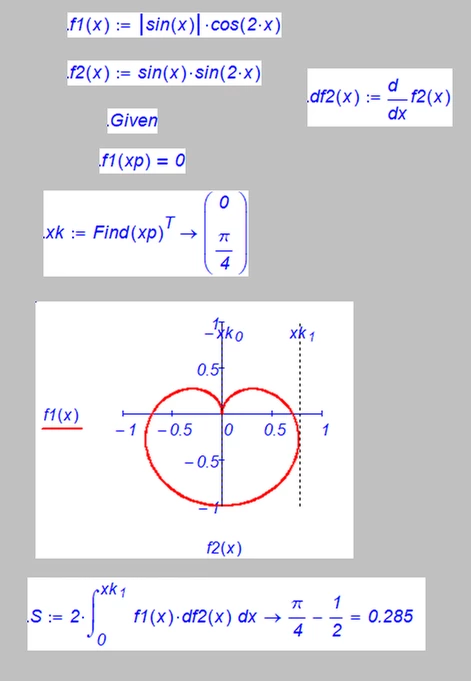

Your curve may look like a cardioide on first glance, but it isn't
Actually what you show is part of a larger curve with the parameter representation
and you get the curve you show for t running from 0 to pi
To calculate the area enclosed you can use Green's theorem  which possibly should be attributed to C.F.Gauß.
Using the parameter representation shown above and the limits 0 and pi for the parameter t, we get the enclosed area with

DJF16-PearlAnswer
Yes, and in fact, the shoelace formula can also be traced back to C. F. Gauß! -> Shoelace formula - Wikipedia
